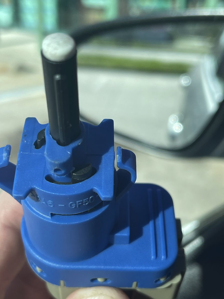

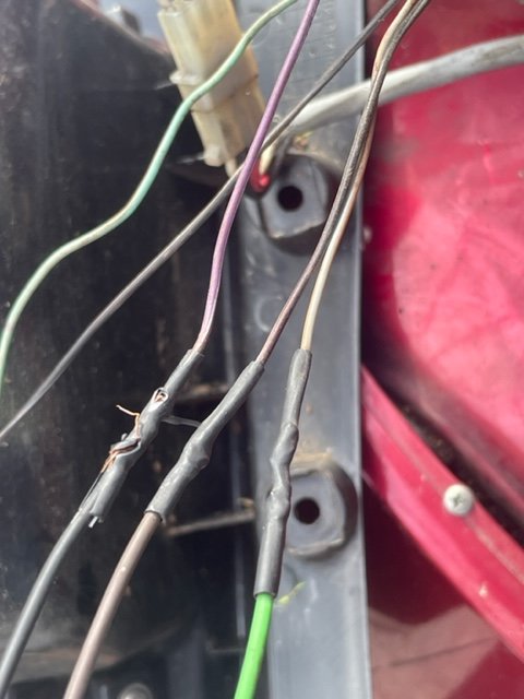

  4. I ended up having to switch all 3 wires. It works now. Fortunately I had a working right side connector to identify the roles of the 3 pins. Photos show the non-Ford connector, incorrect wire pairing, corrected wire pairing, and waterproof wire nuts before reassembly. The person who installed the connector checked that the signals and running lights worked, but must not have tested them together.
  5. My 2009 Edge has a fast blinking left signal from the front turn lamp only whenever the parking lights or headlights are on. With the parking lights and headlights off, the left rear turn signal operates normally. I infer that the stop/turn signal circuit is grounding through the running lamp filament, which can only happen when the running lamp is off. Also that the ground wire for the tail lamp socket is not connected to ground. However I don't understand how the running lamp can ground itself through the stop/turn filament. Anyway, am I correct that I need to find the break in the ground connection? A second possibility is that the ground wire is marginal: sufficient to carry the current of one filament but not two. Edit: Someone had replaced the body-side connector to the left stop/turn lamp. They used a mechanically compatible pigtail connector whose green wire was NOT on the correct pin for ground, but they wired it to ground. I will switch two wires on the pigtail and that should fix it. Thanks so much to @Haz for the detailed information in the other post from a member with what could be the same problem:

  7. Solved. The aftermarket brake switch has a pair of black tabs which rotate 45 degrees. In one position the switch operates correctly for the Edge. Pins 1 and 4 are normally open and pins 2 and 3 are normally closed. In the other position pins 1 and 4 are not connected and pins 2 and 3 are normally open. When you install this switch in the slot and then rotate it 100 degrees or so, the switch changes to the incorrect mode! If you rotate it back 80 degrees all is well. FWIW the debug steps I1 and I2 both resulted in Yes, indicating a defective switch. However the real problem was a dual-mode part. Picture shows the black tabs in the correct position. Thanks again, @Haz.
