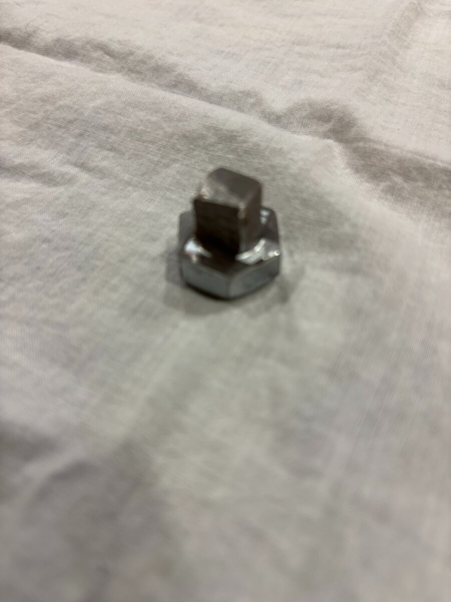

  1. When I changed my RDU fluid, I watched several videos where a pry bar was inserted between the cross frame and the RDU in order to get enough clearance for the socket wrench. When I tried this, I was getting uncomfortable with how much force I was using and still couldn't get enough clearance. Thought for sure I'd risk damaging something if I continued to force it. I solved the problem by getting a large bolt with smooth shank and cutting it down and grinding the shank to 3/8" square. Fit easily and now I use it on many other 3/8" plugs.
