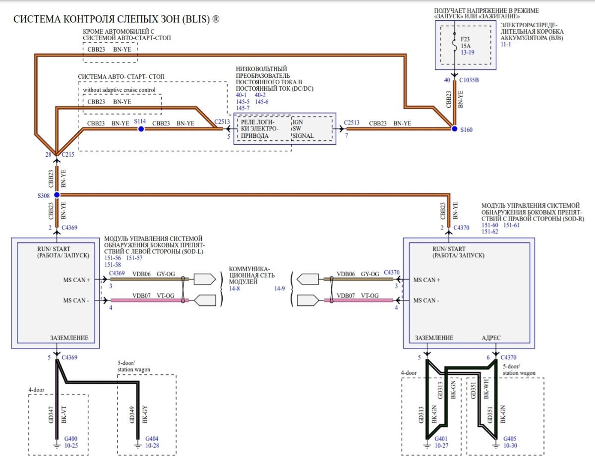

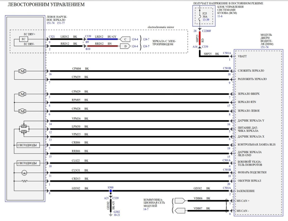

Otomar Posted September 13 Author Report Share Posted September 13 I am adding russina blis scheme for Mondeo MK5. Edge will be same pr similar. No body has access to Ford Wiring database? 1 Quote Link to comment Share on other sites More sharing options...

Otomar Posted September 14 Author Report Share Posted September 14 Thank you for link. There is useful info but no wiring. Quote Link to comment Share on other sites More sharing options...
