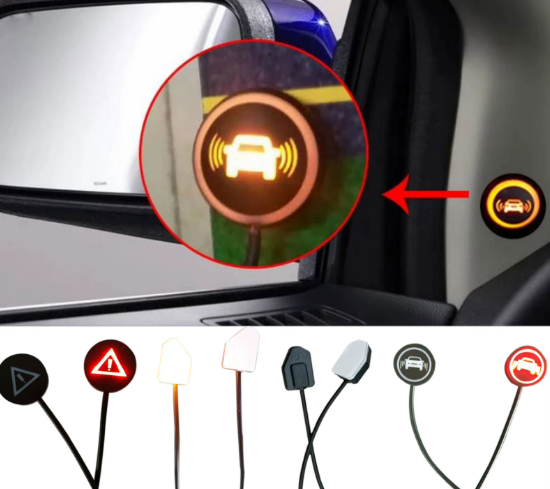

  3. Hi, i created more detailed instructions here: https://www.ford-focus.cz/forum/viewtopic.php?t=55605&start=15 ( You have to be registred probably) - schemes and pictures from assembly available. I am not using LED in mirrors (i do no like it) so I just put small indicators on A pillars trim (PIN 8&9 mirror connector)

  5. I was able to to finalize it last weekend. Each radar must be connected to MS can, power and gnd. Indicator led pins are in mirror connectors. Activation in IPC and door modules. Works perfectly.
