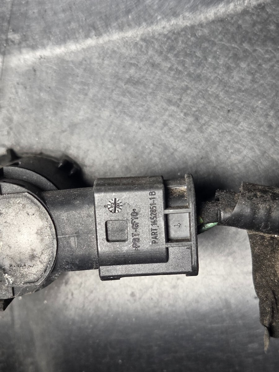

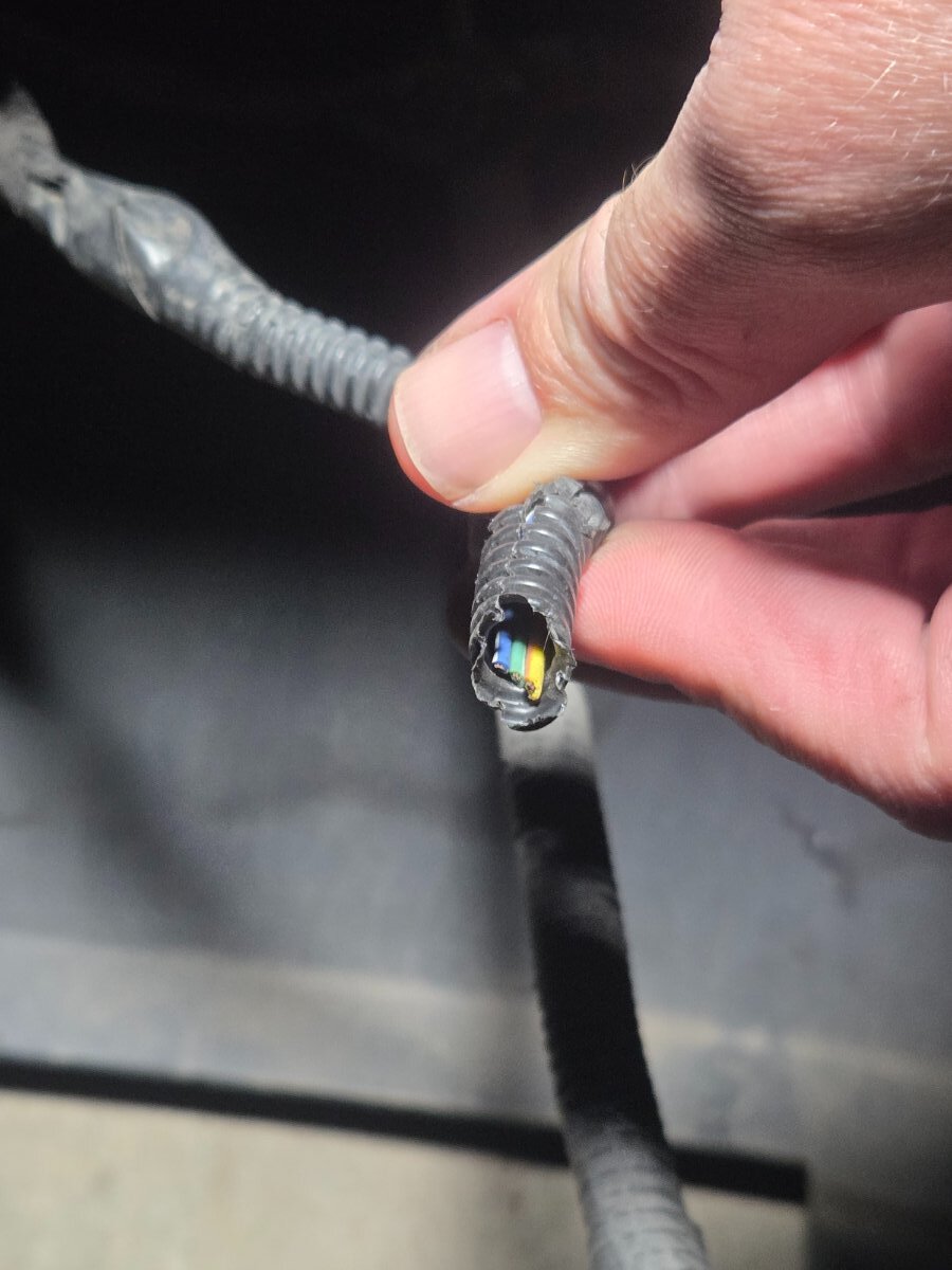

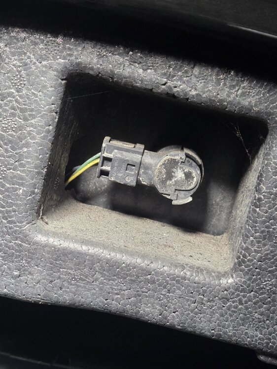

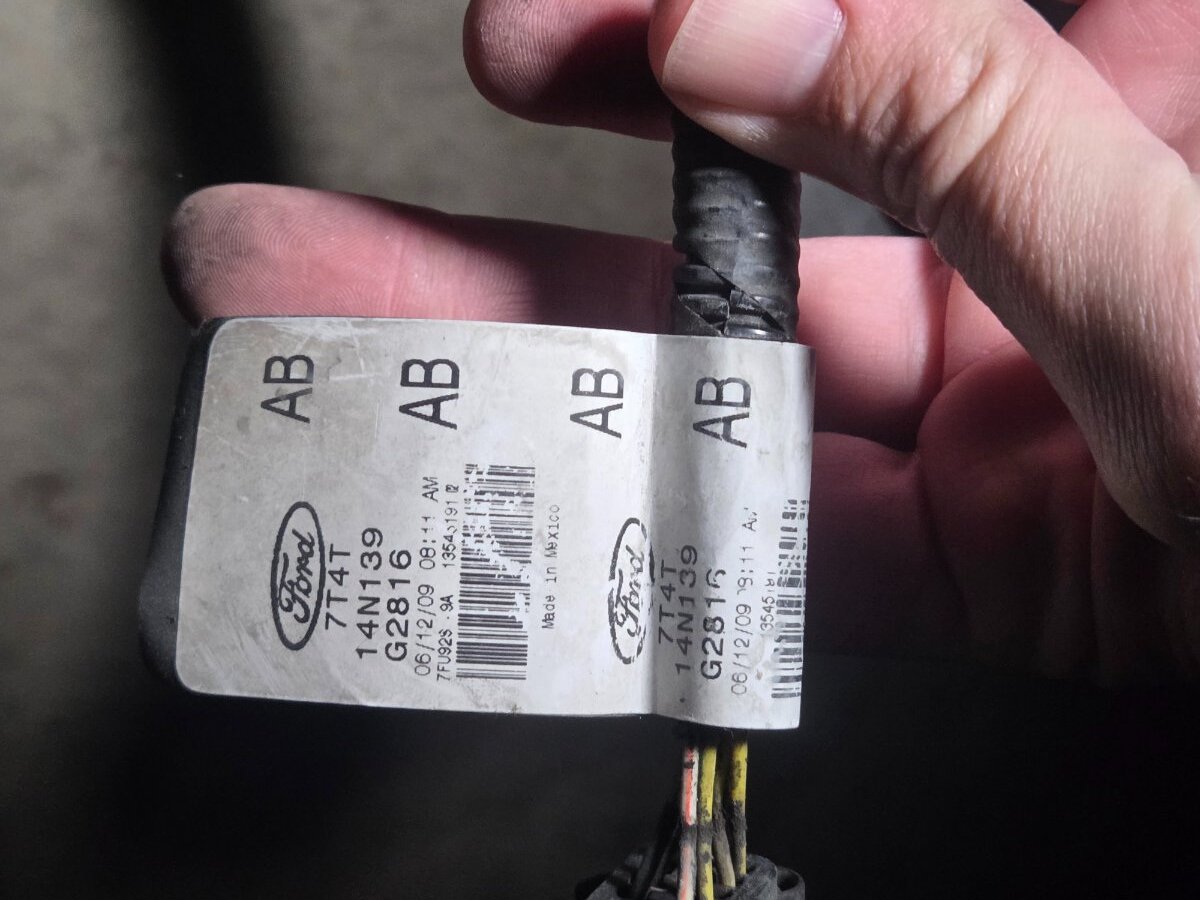

Jared Isham Posted December 16, 2025 Report Share Posted December 16, 2025 I have a 2010 Ford Edge SEL that was rear-ended in the passenger side corner. Being in California they decided to drastically increase the Salvage title restrictions, so in order to get it to pass the VSSI inspection I need to have my bumper replaced or at least assembled without the cracks and with the sensor working. I pulled the bumper off and found that the far left (passenger side) backup assist sensor is completely severed from the wiring harness - not sure if that was the collision company that did that or if that was due to the fender bender. Anyway I either need to figure out how to wire in a new sensor or replace the entire sensor assembly cluster. (Part # 7T4T 14N139 G2816) Does anyone know where I can find that part, hopefully not $300. Or any suggestions on where to get the connector so I can splice in new wire to make the cluster work? Attached is a picture of the part tag, the severed line, and what the assembled sensor looks like Quote Link to comment Share on other sites More sharing options...
edgeidiot Posted December 16, 2025 Report Share Posted December 16, 2025 I found two that are available. Ebay has one for $149 including shipping. 2007-2010 Ford Edge Rear Bumper Parking Sensor Wire Harness 7T4T-14N139 | eBay The other is from a salvage yard in San Fernando, CA for $149 (plus shipping?) FORD EDGE WIRE HARNESS REAR BUMPER PDC 2007 2008 2009 2010 INCLUDES SENSORS You might check your local salvage yards as this part fits all models from 2007 to 2010. 1 Quote Link to comment Share on other sites More sharing options...
Jared Isham Posted December 16, 2025 Author Report Share Posted December 16, 2025 What about something like this for the sensor plug. I am kinda curious to know if I can just splice these wires to where the original sensor was cut and then attach a replacement sensor. $30 is much nicer than $150 https://denalielectronics.com/products/dnl-whs-050 Quote Link to comment Share on other sites More sharing options...
Jared Isham Posted December 18, 2025 Author Report Share Posted December 18, 2025 I actually found it at O'Rielly's https://www.oreillyauto.com/detail/c/standard-ignition/lighting---electrical/connectors---terminals/parking-aid-sensor-connector/f150988703f7/standard-ignition-3-terminal-parking-assist-sensor-connector/std0/s2393/v/a/92778/automotive-suv-2010-ford-edge?q=parking+aid+sensor+connector Hoping to install it soon, but also need to find the bracket that holds the sensor in place on the bumper. 1 Quote Link to comment Share on other sites More sharing options...
