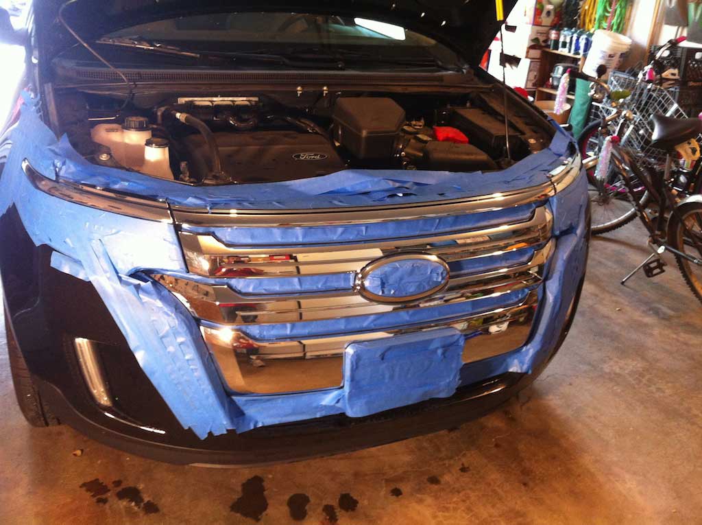

  1. Clean it first, but most importantly, dry it, and everything around it. If water accumulates near the grill, it could drip down while you are spraying. This happened in a few places for me an it left a little mark, but it mostly went away after a few more coats. Blue 3M tape is pretty good too for protecting the lights and vents. Remember to leave a slight gap when masking, you do not want to tape right on the line.
  2. I rubbed my over spray off with my finger. Then I cleaned it up when I washed the car.

  6. I just taped my grille, and sprayed away. Just make sure everything is very dry before you tape.

  8. I used 1 can for my entire front grille, probably 4 or 5 coats. I think you should get 3 cans, just in case, since your wheels should be off the car when you do this. You can always return the unused cans when you are done. Also. Really shake the can at first, a lot more than you would normal spray paint.
