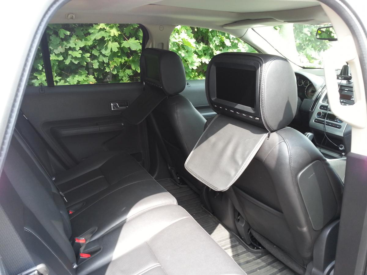

I read up on the many DVD headrest install threads here, and decided on a 9 inch set from OnFair. I was a little hesitant to buy from a Chinese company, but bit the bullet, and after paying them with my trusty PayPal account, waited for them to get to PA. Yea, China to Pennsylvania only took 4 days. Awesome. Install only took 3 hours. Awesomer. Especially since the last time I did much wiring in a vehicle was in an '84 Grand Prix for 2 amps, 4 10s and a pull out cassette deck with a CD changer in the glove box 15 years ago! Used an Add-A-Fuse and grounded back to the factory ground point under the driver's kick panel. Pretty simple stuff, much of which was taken from this site. Thanks!
OK. So now that they're up and running, here's my verdict.
Pros
- Stupid simple to install
- 9" screen
- vinyl color matches almost perfectly
- either unit can be "master", or play back its own source
- wireless IR headphones with built in emitter
- built in FM transmitter

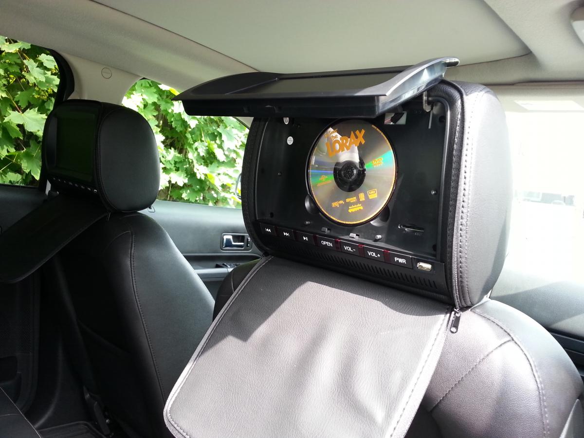

- USB, SD card or discs can be played
- 2300 games...with wireless controllers
Cons

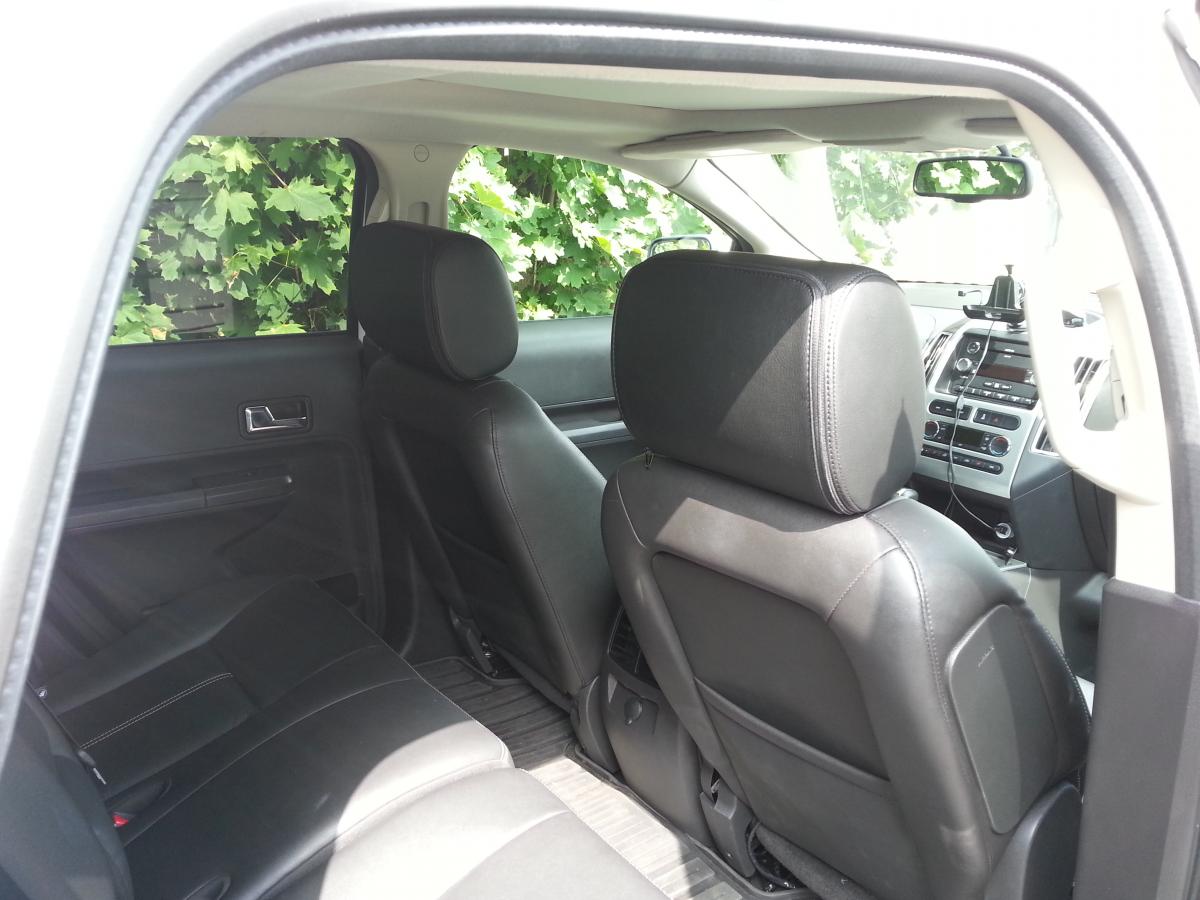

- No contrast stitching like on the front seats
- grain of the vinyl is not a perfect match, but the wife didn't even notice until I pointed it out
- remotes are not specific to a particular headrest; when you press a button on your remote, it will probably send the same command to the other headrest cuz they're so close to one another
- lost the ability to adjust the headrest up since they're heavier. They are a LOT bigger though, and at 6'1" it's not a problem for me
Overall, for a shipped-to-my-door price of $244.50 I am completely satisfied with this purchase. As time goes on, we'll see how they age and stand up to our 7, 9 & 11 year olds, and I'll update this post as things happen.
