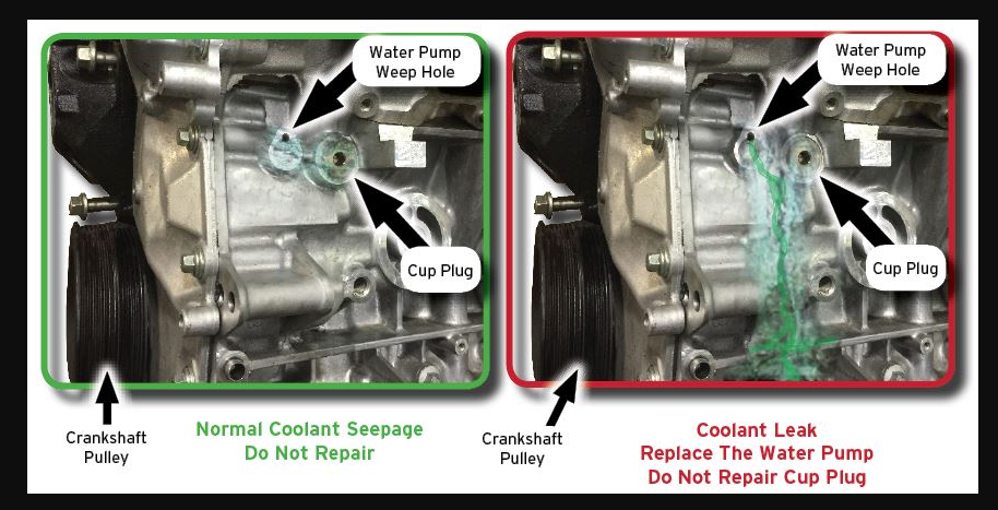

  4. Was digging around online and found this picture of the Water Pump Weep Hole drain on the 3.7L Mazda engine, which I believe is the same as the Ford 3.5/3.7 L engines.
  5. Sorry, it is a 3.5L engine. Everything up above in the cooling system looks clean. I was wondering if a head gasket leak would end up in this area, or (after reading the forums this morning) if the water pump weep hole might be the issue. Might have to invest in a small USB camera to have a look. It is going into the dealer Monday for this and a bunch of other issues: Right axle Shaft leak, right inner tie rod sloppy, squeaky temp door actuators in the HVAC, possible right wheel bearing etc.
  6. Coolant leaking not leaning. I guess I should have had my coffee before posting! 2013 Edge 3.5L has what appears to be red sticky coolant leaking onto the AC Compressor and then dripping into my garage floor. The coolant bottle is down just an inch or so. I am wondering and looking for a picture of what is located above the compressor that would leak externally?
