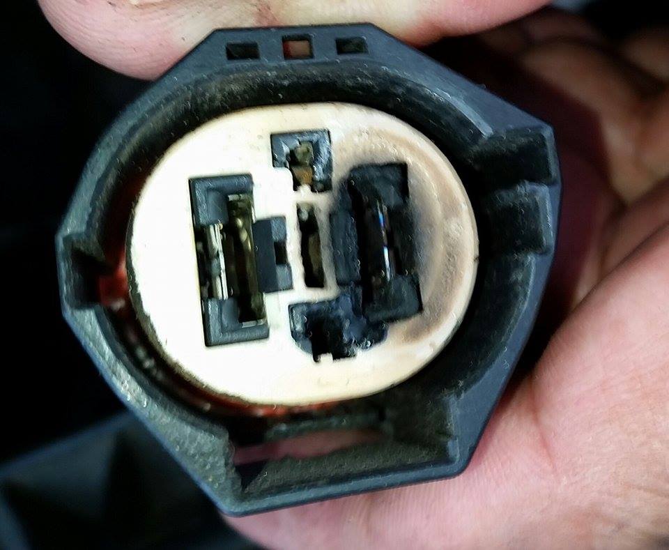

  3. Fixed plug and codes went away and next day codes popping back up. Now I have P0060 HO2S Heater resistance (Bank2, Sensor 2) P1000 OBD SYSTEM READINESS TEST NOT COMPLETE What are the odds of the O2 sensor going out at the same time?
  4. Found the problem. Plug was burnt so it caused a short in wires Thanx for your help!

  6. The fans are working properly but still getting codes. I erased the codes and they popped back up
  7. I have a 2007 Edge and had a local mechanic swap out my coolant fan. I purchased the fan and he did the labor. I am driving home and the check engine light pops up. Got home and put the scanner on and these are the codes that popped up. P0060 HO2 HEATER RESISTANCE (BANK 2, SENSOR 2) P0480 FAN 1 CONTROL CIRCUIT P1000 OBD SYSTEM READINESS TEST NOT COMPLETE ANYBODY KNOW WHAT CAN CAUSE ALL OF THESE ALL OF A SUDDEN? ANY HELP WOULD BE GREATLY APPRECIATED.
