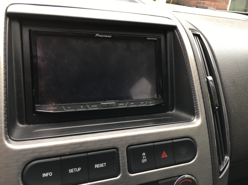

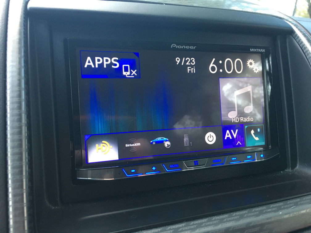

  16. I had the nav unit in my 2010 Edge replaced last week with a Pioneer AVH-4200NEX. This unit doesn't have navigation built-in, but it does have Apple CarPlay and Android Auto support. If you've ever shopped on Crutchfield, you'll know that they claim units with slide-out faceplates like this one don't fit. While I have no doubt that is true if the unit is large enough due to the way the units sit back in the dash a bit, these 7" Pioneer units fit just fine with plenty of clearance from the dash when opening up to insert a CD or SD card.
    I did have the iDatalink Maestro installed with the FO1 harness to maintain full Sync options. That was a great choice! The head unit is able to give me readouts for a variety of performance information, including something as simple as the tire pressure. I also have full control via the steering wheel controls as before, and you can customize those controls when you flash the Maestro. I still have Sync voice dialing and Sync controls for media playback. Sync will still recognize USB drives in the port inside the armrest. The Pioneer head unit itself won't read that, but does have a slot for SD cards that you can put media on (Sync does not recognize the SD card and Pioneer has no voice controls for that).
    I had a bizarre problem with the subwoofer output... it was anemic and no adjustment of the EQ or other audio settings made a difference. Then my car failed to start yesterday and it turned out my battery had some bad cells in it. Got a new car battery, and suddenly the subwoofer is performing up to expectations. Best guess is the new head unit is drawing more power than the old, and it pushed what already had to be a failing battery too far and it couldn't deliver enough power to the amp for it to perform properly.
    I lost factory Sirius integration due to pulling out the OEM head unit. I had some bad info from the iDatalink website early on. The Pioneer head unit is supposed to retain factory Sirius integration when used with the Maestro, but as it turns out, starting with the 2009 models (if I recall correctly, it may be mid-2009 before the change), the Sirius tuner is built into the OEM nav head unit. Non-nav units still have an external Sirius tuner. I can also confirm that you can re-use the factory Sirius antenna with an aftermarket Sirius tuner... you just have to remove the yellow plastic clip that surrounds the antenna connector.

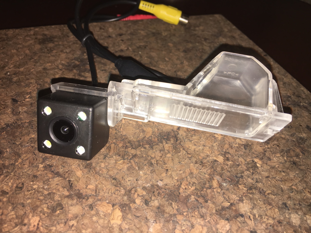

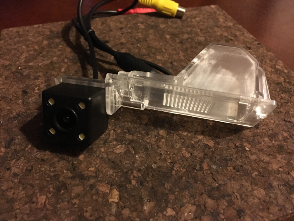

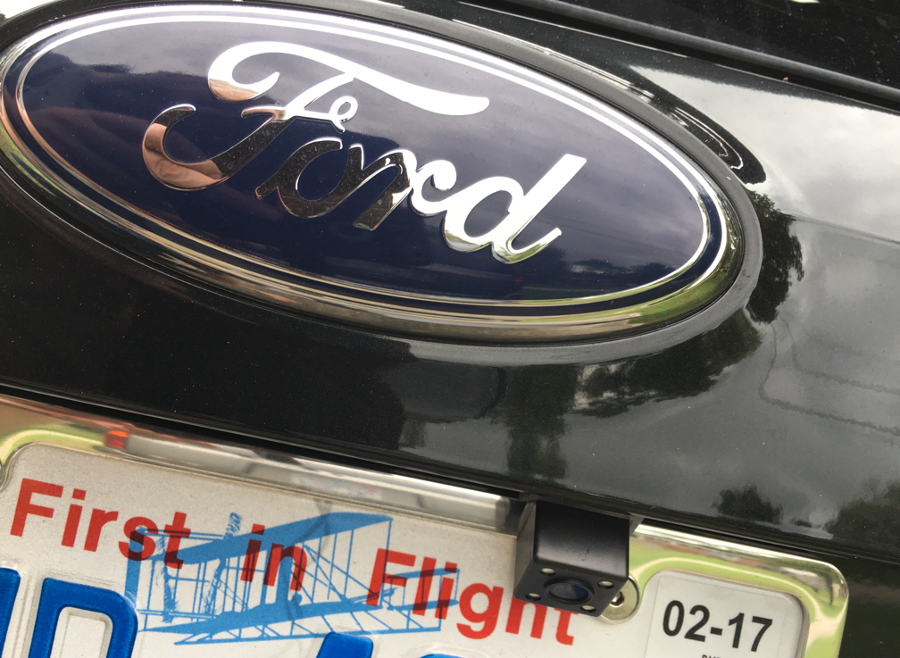

    I also had a backup camera installed. I grabbed this off Amazon, made by Moonet. This camera is attached to a replacement for the right-side license plate light. No drilling required! The angle is a little steep, and the image quality is quite terrible to be honest, but it gets the job done. It has LED lights for nighttime, but they don't help much. I may replace this with a better camera some time in the future.
    Photos attached... if there are any questions or more pics/demos desired, feel free to ask. All in all, I am very satisfied with the change. The big reason behind it was because the maps in the OEM nav unit were 7 years out of date (the prior owner never updated it) and the current update kept failing when I tried to install it. So now I can use Apple Maps directly from the Pioneer courtesy of CarPlay. Apple Maps has its own issues, but they are still much better off than what the Ford unit was providing. GPS was often far off and once when I was meeting family for lunch, the community we were meeting in didn't exist seven years ago. In other instances, highways had been reconstructed, exits changed... it was horrible relying on it.
