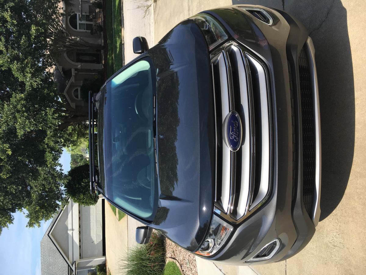

  1. I have these funky flush mounted roof rails installed on my fleet Edge. After a trip to the dealer looking for crossbars, I came home with gen1 cross bars, which do not work since the gen2 rails have no where to screw crossbars into. The only options ATM are the Rhino Rack ja1738 (pictured) or Thule for 500+. The are a clip on style used on Volvo or BMW. Crazy Ford makes roof rails with no crossbars... Anyway so far, so good with the bars.
