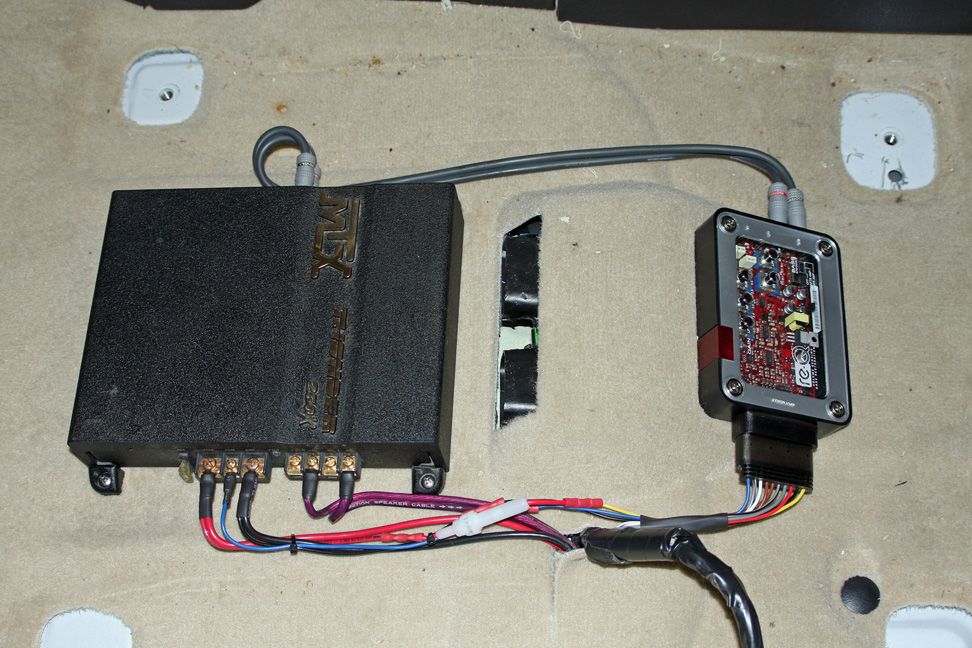

White was more of a tan than a white - here's the wire colors going to the back of the head unit - I've noted the pin# (larger 24 pin connector of the 2) for the signals I spliced into: Car Radio Battery Constant 12v+ Wire: White/Red #02 Car Radio Accessory Switched 12v+ Wire: Blue (remote-out) Car Radio Ground Wire: Black/Blue Car Stereo Antenna Trigger: Yellow/Green Car Stereo Amp Trigger Wire: Purple/Red (didn't use this) --- #08 Left Front Speaker Positive Wire (+): White #21 Left Front Speaker Negative Wire (-): White/Brown --- #11 Right Front Speaker Positive Wire (+): White/Purple #12 Right Front Speaker Negative Wire (-): White/Orange --- #09 Left Rear Speaker Positive Wire (+): White/Green (didn't touch this) #22 Left Rear Speaker Negative Wire (-): Brown/Yellow (didn't touch this) --- #10 Right Rear Speaker Positive Wire (+): Brown/White (didn't touch this) #23 Right Rear Speaker Negative Wire (-): Brown/Blue (didn't touch this) Mounted the Re-Q and the sub's amp under the front pass seat - see the pic. Good clearance, protected, and easy access to settings, but then my pass seat is a manual... Ran the +12V sub amp cable through the driver's side firewall bushing containing the main fuse block's wire bundle. Made a small cut (very carefully!) in the boot next to the bundle and pushed the 8ga power cable through it. For the Re-Q's power, I Yed off the amp's +12V and Ground connectors. Don't confuse the Re-Q's rmt-IN (from #02 above) and rmt-OUT (to the sub's amp). -
