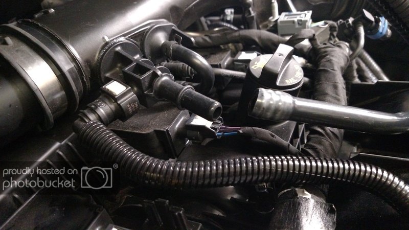

Here's what I've found.
Seems like you plug in right before the intake manifold? Then into your catch can, then from your catch can back into the vacuum line
on top of the engine.
Snagged the pics from the link, thanks!
First location

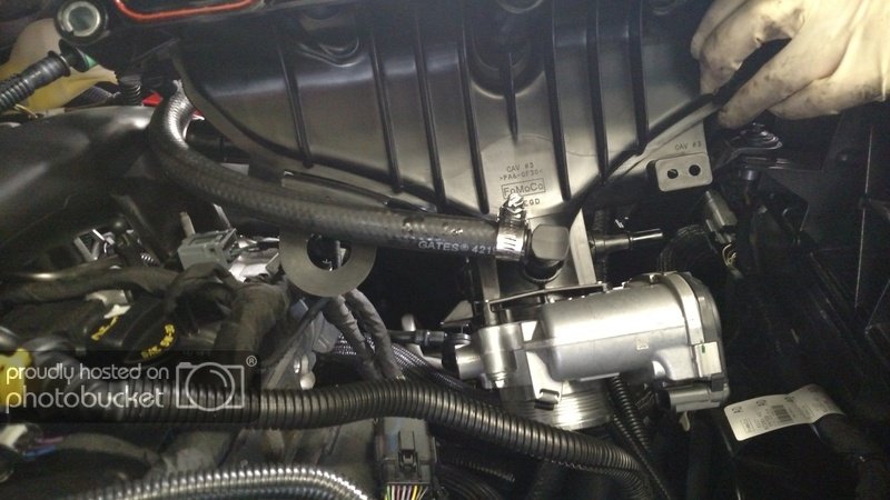

Then to catch can?
Then to vacuum intake
