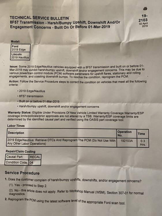

    Does anyone know if the TSB for the 8F57 Transmission - Harsh/Bumpy Upshift, Downshift and/or engagement concerns applies to all models with this transmission? I have a 2019 Ford SEL with the 8F57 transmission and am experiencing the same issue. Been in the service department 4x for more than 21 days total until the manager drove it and documented a problem in low speed performance between the 3rd and 4th gears. Was told that I am the only one who has presented this complaint to Ford engineering which must be untrue based on what I have seen thus far. Can anyone provide some insight?

    I have a 2019 Ford SEL with the 8F57 transmission and am experiencing the same issue. Been in the service department 4x for more than 21 days total until the manager drove it and noticed a problem in low speed performance between the 3rd and 4th gears. Was told that I am the only one who has presented this complaint to Ford engineering which must be untrue based on what I have seen on the forum. Does anyone know if the TSB for the 8F57 Transmission - Harsh/Bumpy Upshift, Downshift and/or engagement concerns applies to all models with this transmission? Will also post on the ST forum...
