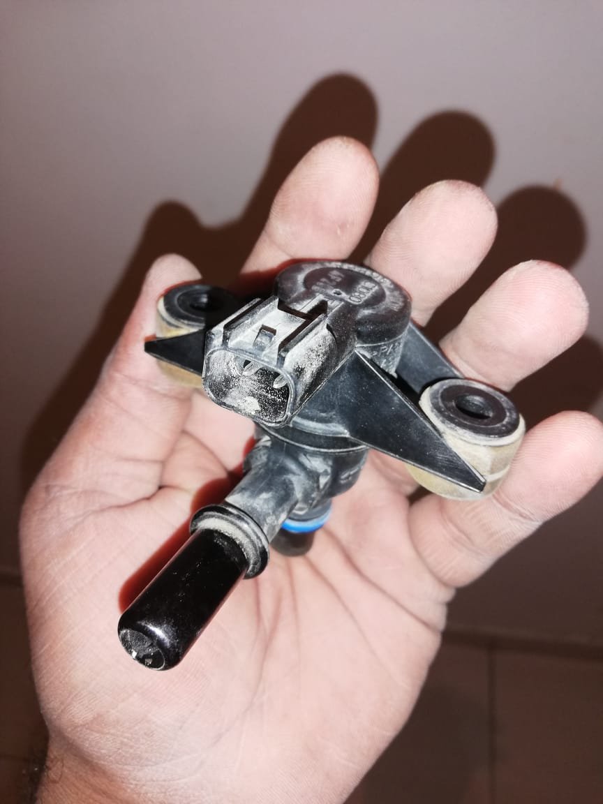

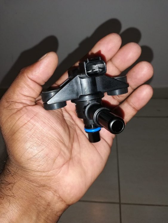

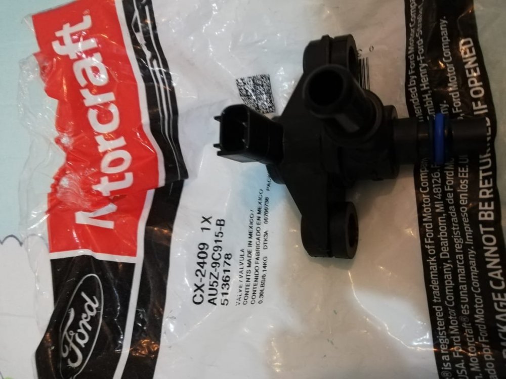

  1. It was the EVAP purge valve. I replaced it and the vehicle is perfect now.
  2. Just went through the same issue in my 2013 SE and it was the purge valve. Initially noticed low/varied RPM and engine stall, difficult to start after refueling. I changed my EVAP purge valve and sorted the problem.
