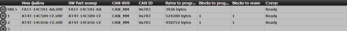

  4. HCM-K2GT-13C148-DD ist galaxy modul from 2020 C-CM -RADAR - JX7T-9G768-AC PSCM-K2GC-3F964-AF SCCM-KT4T-3F944-GAC GWM-L1GT-14F642-BC ist galaxy modul from 2020 IMPA--KT4T-19H406-CE Done🤝

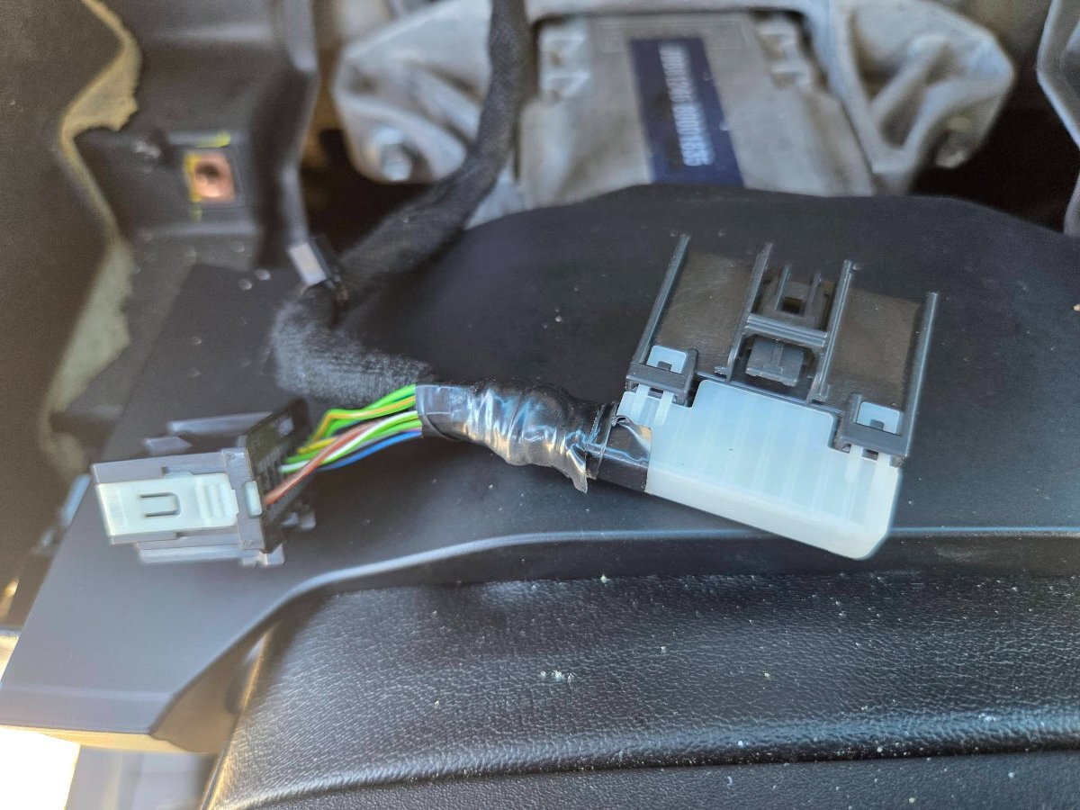

  5. WACM – wireless charger. Connects to the HS3 bus and must be activated in the APIM. The installation method is improvised. Hardware: JX7T-19J235-BC

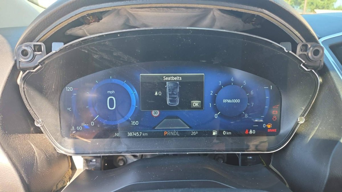

  6. I’ve started the retrofit: currently installing the CCM with its own bracket and the IPM-A with its own bracket; I’m swapping the SCCM for button compatibility and adding an HCM module from a Galaxy so the matrix headlights work—the bus wiring had to be changed as well. I still need to swap the PSCM, but I have to put that on hold since I’ll be away for three weeks. I’ll add the configuration and all the details—including the parts used and more detailed photos—after the replacement is done. -----------------The adaptive cruise control and lights are already working; for lane centering, I still need to replace the PSCM. Lane Centering for 2015–2018 models. Below is the list of hardware and settings that needed to be added/configured. Required configuration changes: IPC: Enable Traffic Jam Assist PCM: Cruise control with Stop & Go BCM: Cruise control with Stop & Go IMPA: TJA enabled SCCM: Left-hand stalk parameter set to 61 PSCM: Enable all extra features, including TJA ABS: Set "stop" value to 0

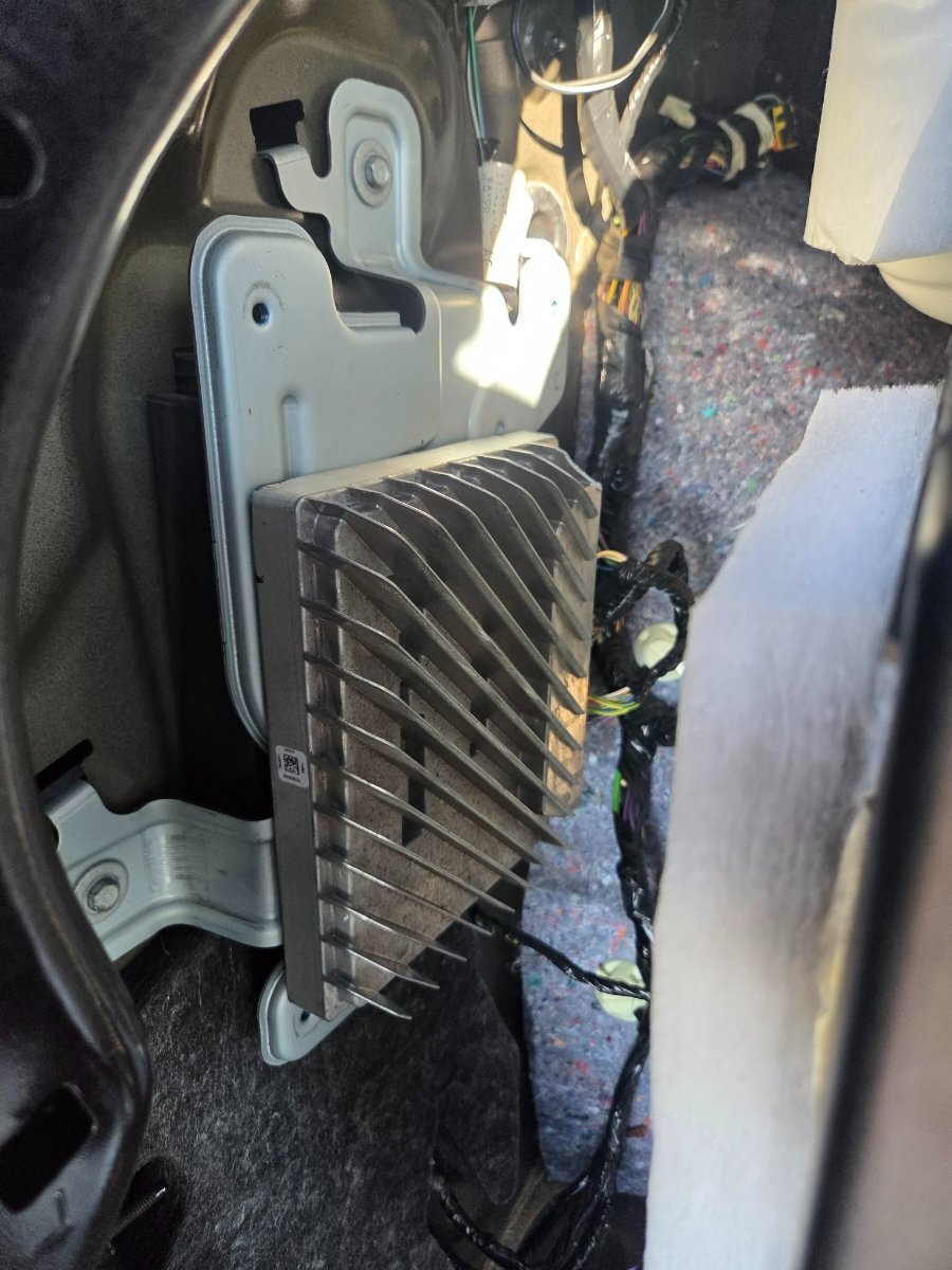

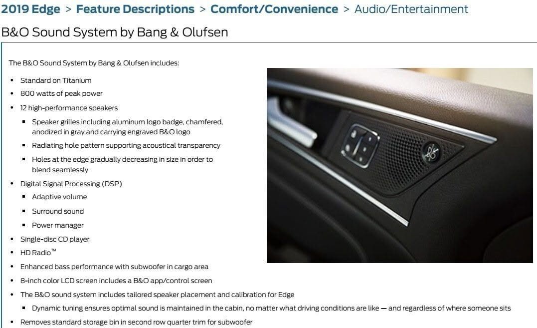

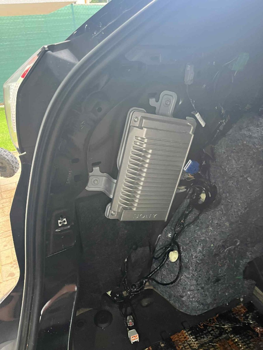

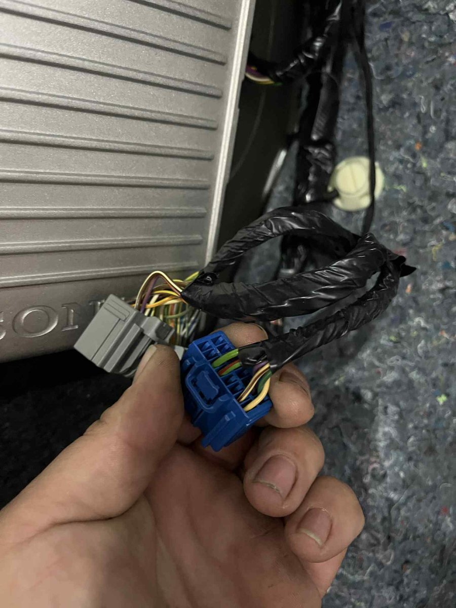

  7. It is located on the left side in the trunk. You just need to repin the power connection, because Sony wires the power differently. Sony power pin + 5,6 to 8,16 Bang & Olufsen Sony -negative cables from 13,14 to 5,13 Bang & Olufsen parts : KR3T-18T806-CJ B&O 900W Flash firmware

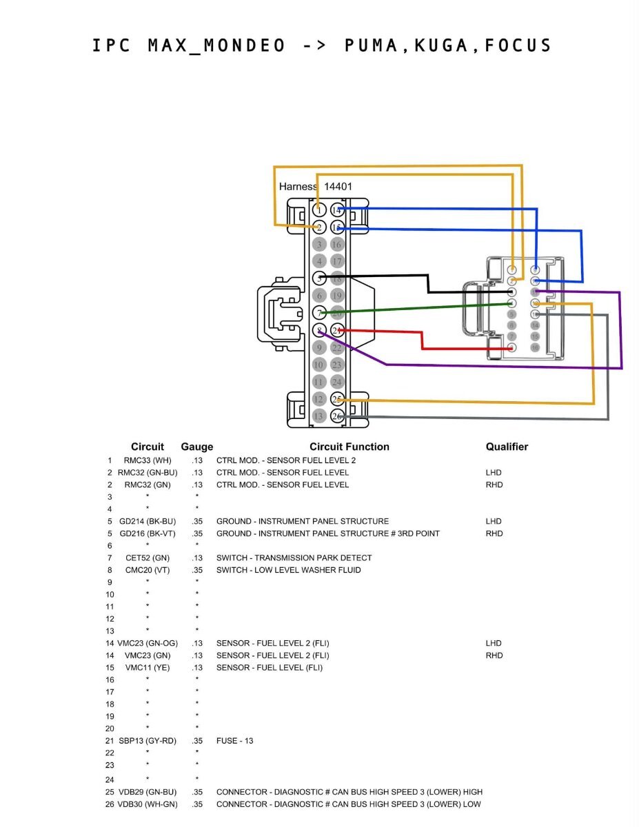

  8. I will try but I only have access to the schemes in Europe. It would be a good idea to check the connectors and their pinout in your vehicle and compare them; if the wiring matches, the only difference is the coding—meaning the As-Built data will differ, but the electrical setup will be the same. The Edge is manufactured in Canada, even for the European market.
