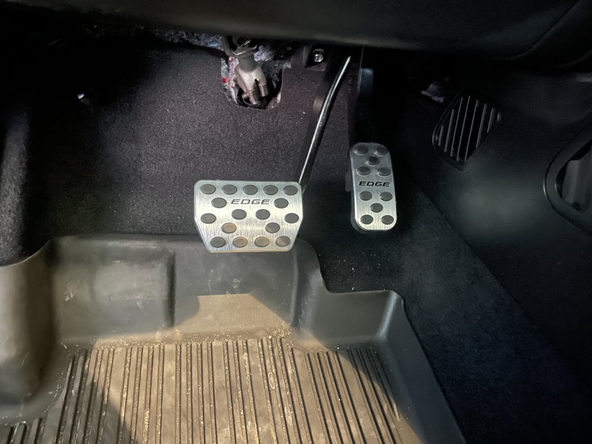

Here is my latest mod pedal covers, I think they add a nice touch to the pedal area. Purchased from Amazon
