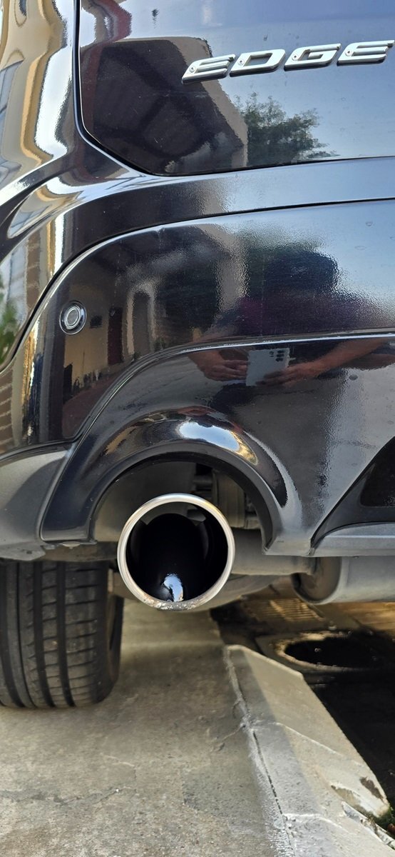

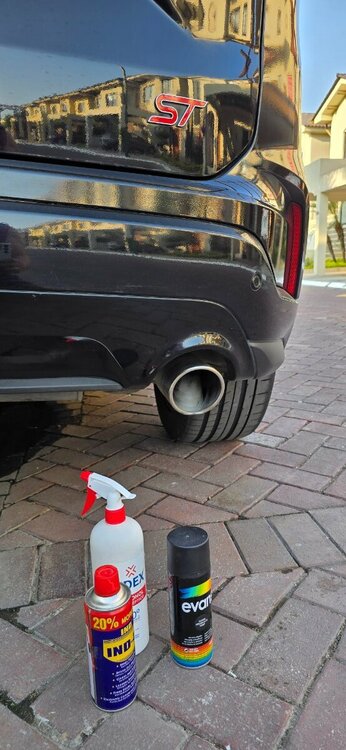

Just cleaned the inside using water and alcohol, then I sprayed it with high temp black paint. (I had a leftover can that i used to repaint my bbq, lol)

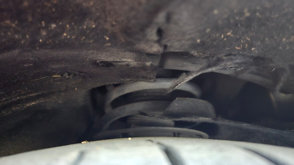

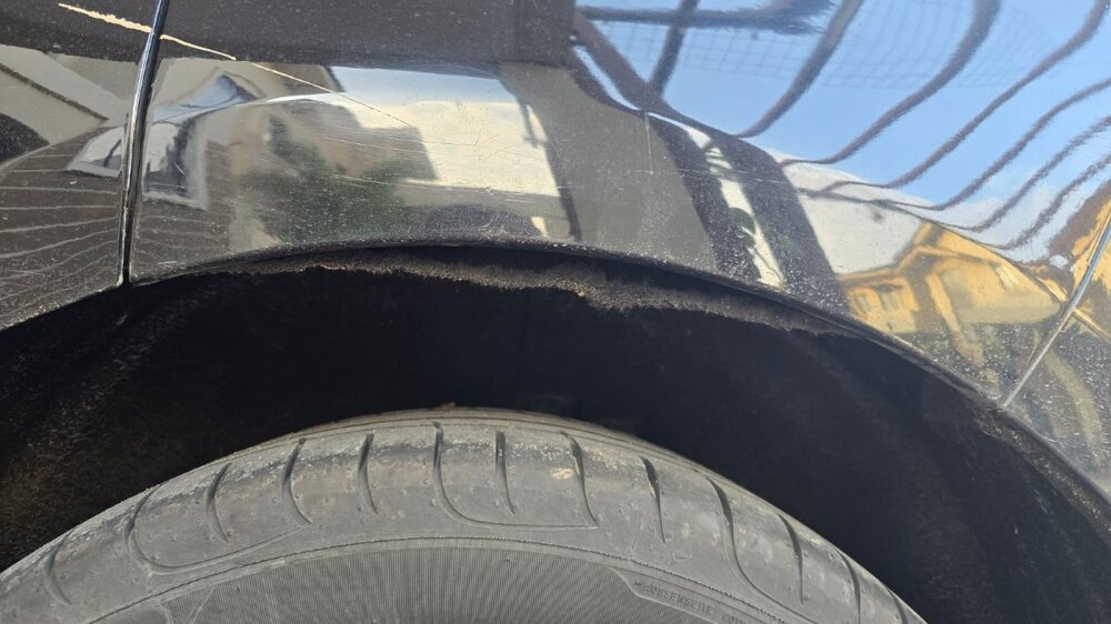

I'm using 285/45 R20 According to Tire Calculator, they are 1.53% bigger than the original 245/50 R20 (This is within acceptable variance, according to the app) Original tire circumference: 93.13in Current Tire circumference: 94.56in Do you think that could be the problem ? Im currently looking to replace shocks and bump stops... any aftermarket good option at a reasonable price ?
