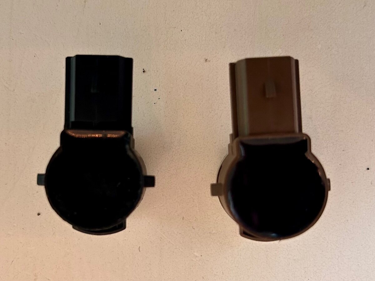

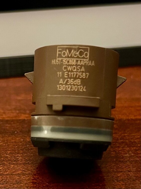

Wubster100 Posted May 30 Author Report Share Posted May 30 I got the long range sensor, and placed it on the passenger side. Comparing it to the standard parking sensor, it is a little bit thicker. However, the plug on it has a slightly different key than the other sensors. I first tested it by temporarily taping it to the car. With this correct sensor, active park assist is working perfectly! In order to plug in the sensor, I had to remove the plastic key so that it would fit. 1 Quote Link to comment Share on other sites More sharing options...
