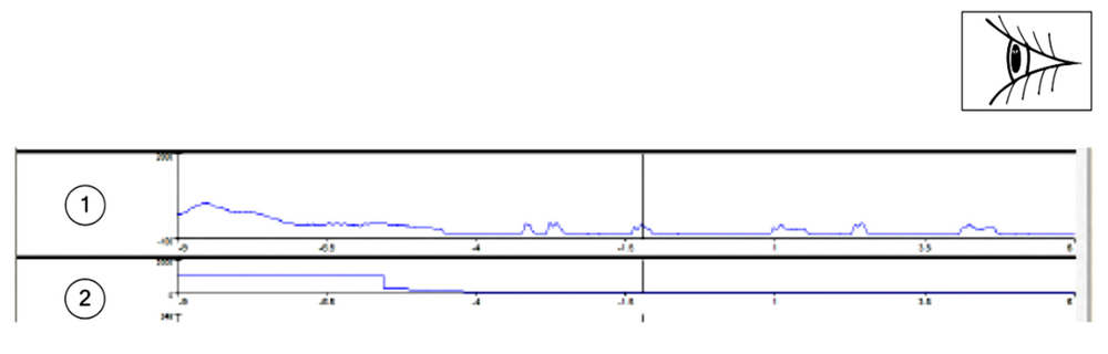

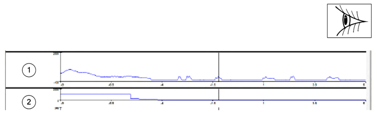

Issue: Some of the vehicles listed in the Model statement above exhibit all of the following conditions:
• Shudder condition, most noticeable at speeds below 60 mph (100 km/h)
• No DTCs present
• Traceable shudder event with IDS/ FDRS reading. Refer to Figure 1.
Sometimes this is perceived/felt as an engine misfire. This may be due to an internal issue with the torque converter.
Action: For vehicles that meet the criteria in the Issue and Model statements, follow the Service Procedure to replace the torque converter.

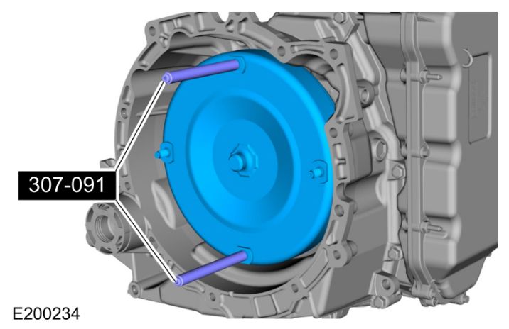

1. Drain The transmission fluid. Refer to WSM, Section 307-01.
2. Remove the transmission. Refer to WSM, Section 307-01.
3. Remove and discard torque converter. Refer to WSM, Section 307-01.
4. Replace the torque converter seal. Refer to WSM, Section 307-01.
5. Install the replacement torque converter. Refer to WSM, Section 307-01.
6. Reinstall the transmission. Refer to WSM Section 307-01.
7. Refill the transmission to the correct fluid level. Refer to WSM Section 307-01.
8. Reprogram the PCM using the latest software level of the appropriate scan tool.
