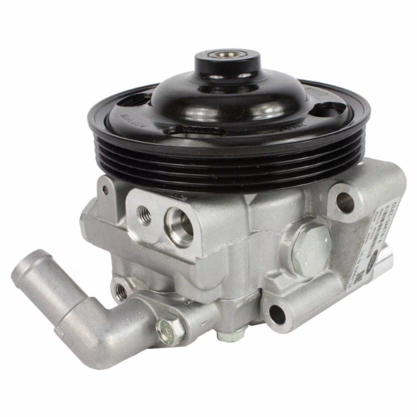

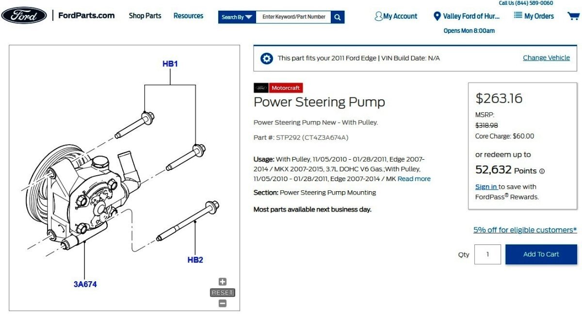

If it proves necessary, the Removal and Installation procedure for the power steering pump is also attached below.
Link to this FordParts webpage
PowerSteeringPump-CT4Z3A674A-FordParts_com.thumb.jpg.6cea93a256114a34c7b19085c83d4fd7.jpg
