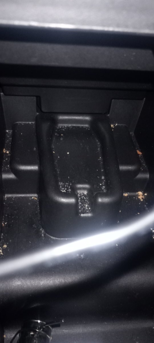

sounduser Posted May 12, 2025 Report Share Posted May 12, 2025 What's this for in the centre console storage compartment? 1 Quote Link to comment Share on other sites More sharing options...
dabangsta Posted May 12, 2025 Report Share Posted May 12, 2025 That is called the Backup slot. That is where you would place your key fob if the battery was dead, or for some other reason it wasn't detected in the cabin (try to start and it says "no key detected"). Also it can be used to program a new key, and to get your securicode door keypad code. 3 Quote Link to comment Share on other sites More sharing options...
GTSnake Posted May 18, 2025 Report Share Posted May 18, 2025 Comes in very handy when your fob battery dies and you don't have a new battery. You put your fob on top so you can start the car and get home. Happened to me once and so glad I remembered this. 1 Quote Link to comment Share on other sites More sharing options...
