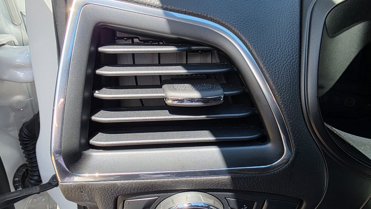

Jetboy47 Posted May 21 Report Share Posted May 21 What is the recommended / best way to remove and install the air vent by the drive side window. I ordered the part #EM2Z-19893-BN but would really like some guidance. Quote Link to comment Share on other sites More sharing options...

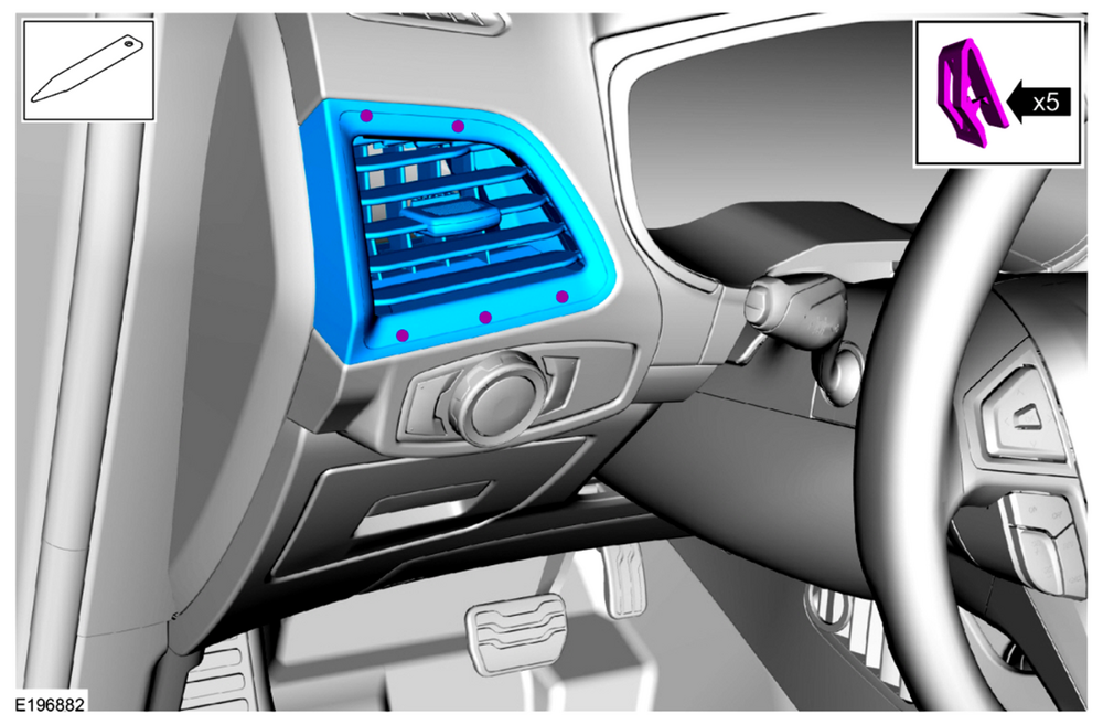

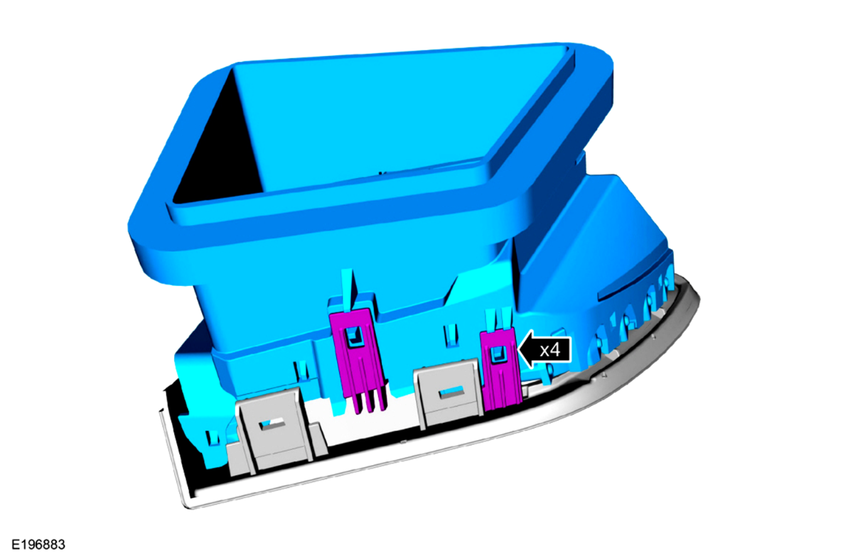

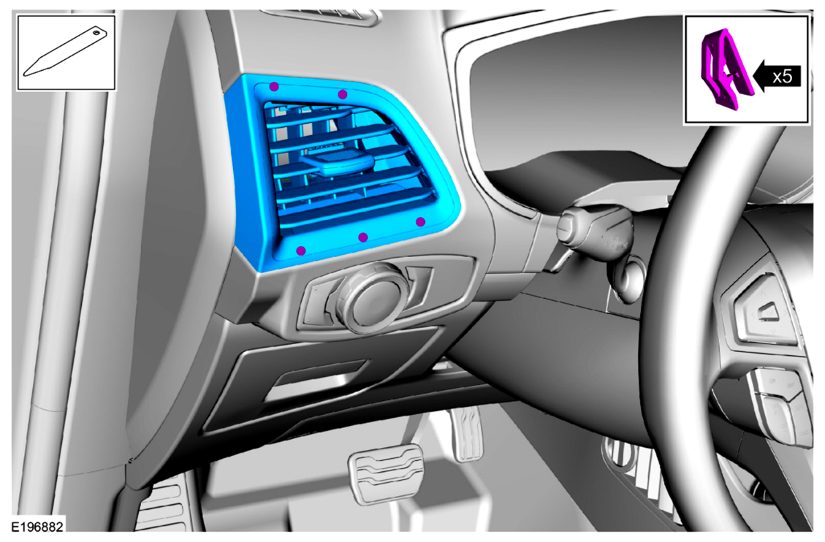

Haz Posted May 21 Report Share Posted May 21 Welcome to the Forum @Jetboy47! The following is the Workshop Manual removal and installation procedure, which is also attached below as a PDF file... Driver Side Register Special Tool(s) / General Equipment Interior Trim Remover Removal Release the clips and remove the LH instrument panel finish panel. Use the General Equipment: Interior Trim Remover Release the clips and remove the driver side register assembly. Installation To install, reverse the removal procedure. Ford's online parts-selling site provides photos showing fuller detail of the retaining clips... Link to this FordParts webpage Good luck! Driver Side Register - Removal and Installation - 2022-2024 Edge Workshop Manual.pdf 2 1 Quote Link to comment Share on other sites More sharing options...

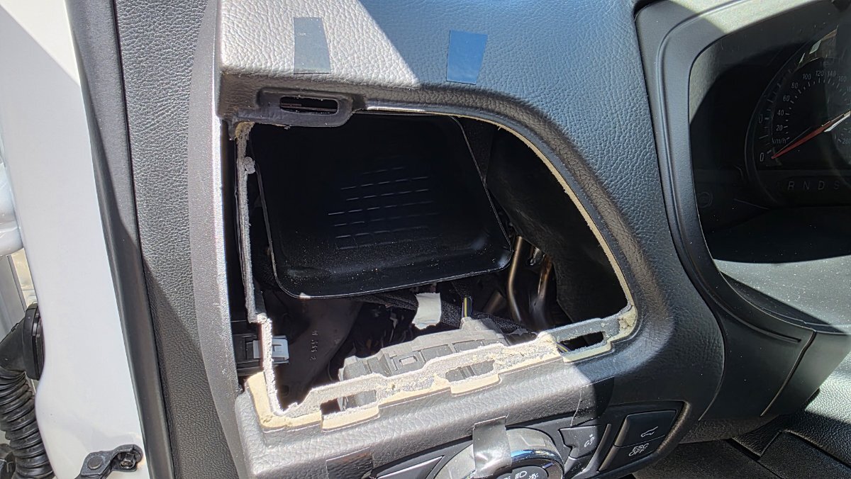

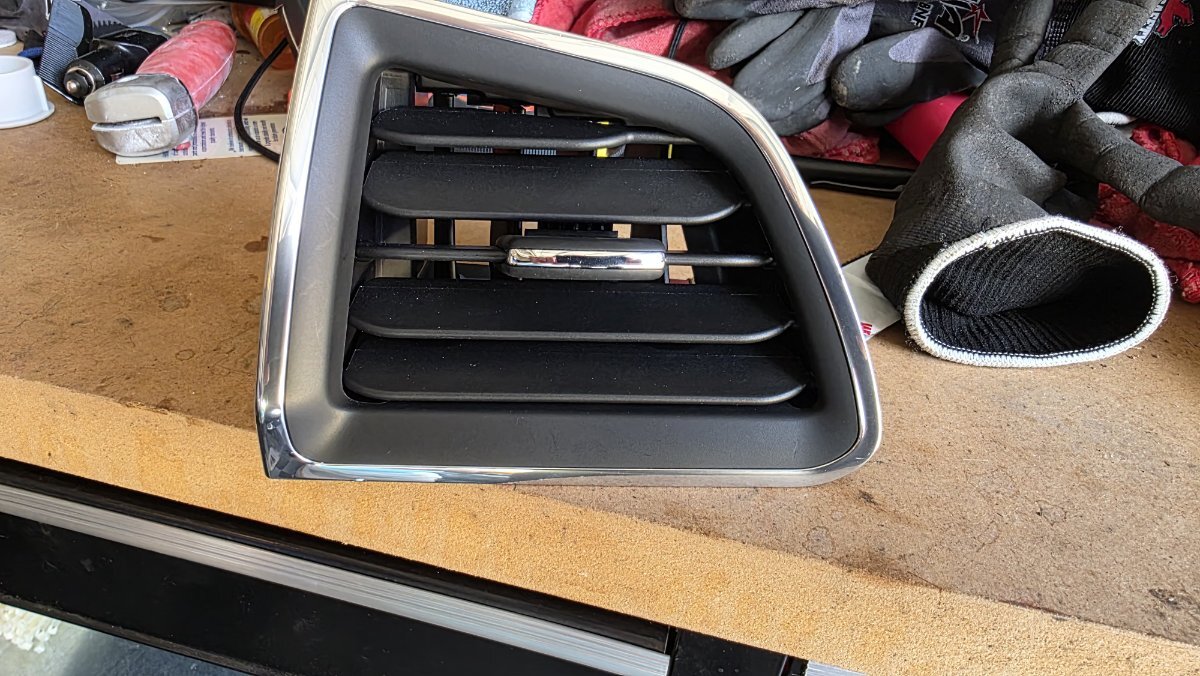

Jetboy47 Posted June 3 Author Report Share Posted June 3 Replacing the vent went well. Thanks again for the help Haz! 20250530_114754.heic 20250530_114804.heic 20250530_115403.heic 1 1 Quote Link to comment Share on other sites More sharing options...
