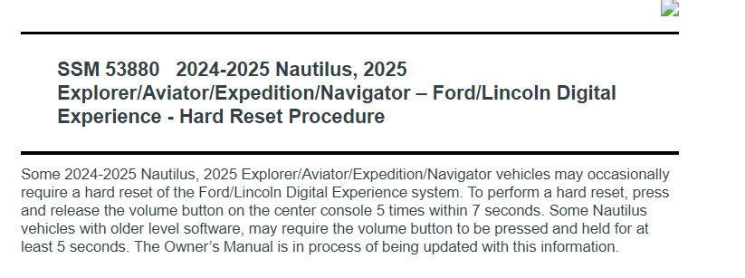

Haz, I saw this today.  Is the "hard reset" what we called the "reboot" where you push and hold the knob about 10 seconds? The manual discusses reboot and master reset but not hard.
Edited by Bunky
@Bunky: The Special Service Message you cite also posted overnight to OASIS on the Professional Technician System (PTS) website...
Historically, system/module resetting actions have been described in various terms, such as soft or cold rebooting, or master or hard resets.
In the past, hard resets involved battery disconnects or fuse removals that produced the most drastic effects, by restoring factory default states that eliminated owner-added data, owner-configured features, and driving-learned module configurations.

We'll have to wait for the Owner's Manual and Workshop Manual rewrites to gain full understanding of Hard Reset effects, or, you could perform the SSM-described procedure and report-back on its possible drastic and wide-reaching effects.
I'd wait for the rewrites, instead of having to perform re-do's to the numerous personal configurations & settings that you've refined over time.
