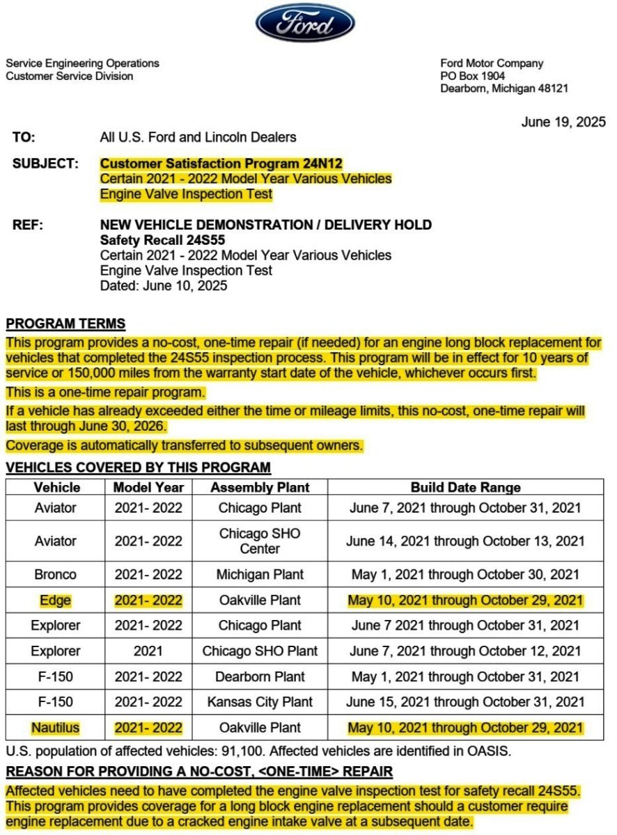

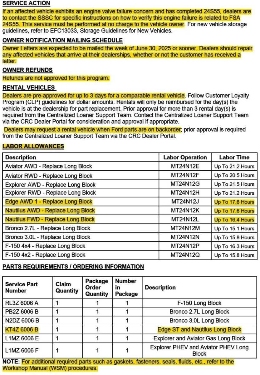

Haz Posted June 20, 2025 Report Share Posted June 20, 2025 *** The following Dealer Bulletin has been edited to provide the information most relevant to Forum members. *** 3 Quote Link to comment Share on other sites More sharing options...
