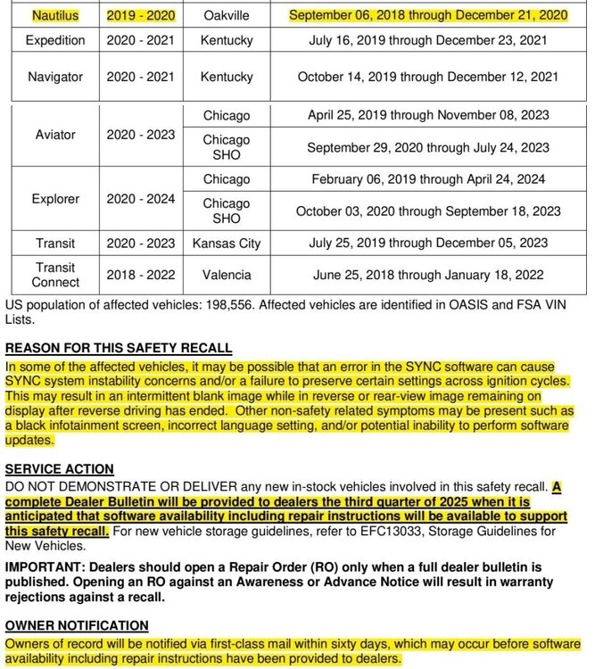

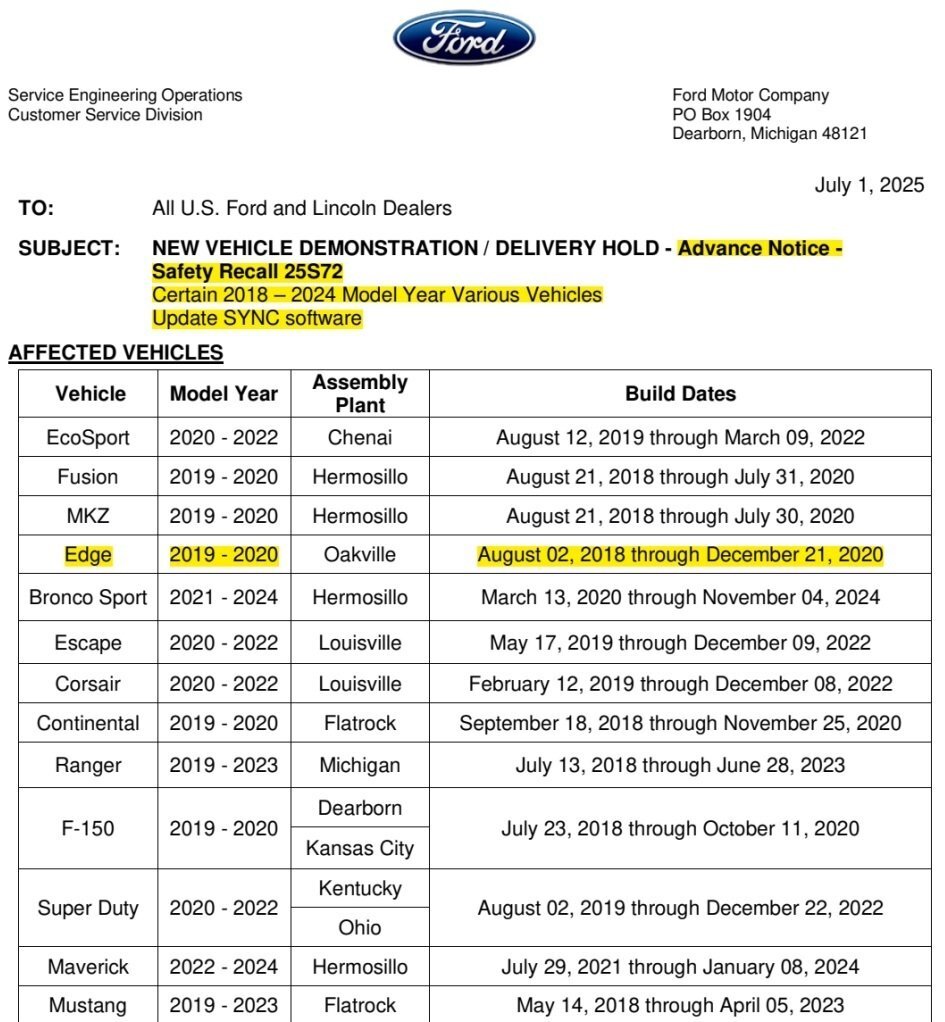

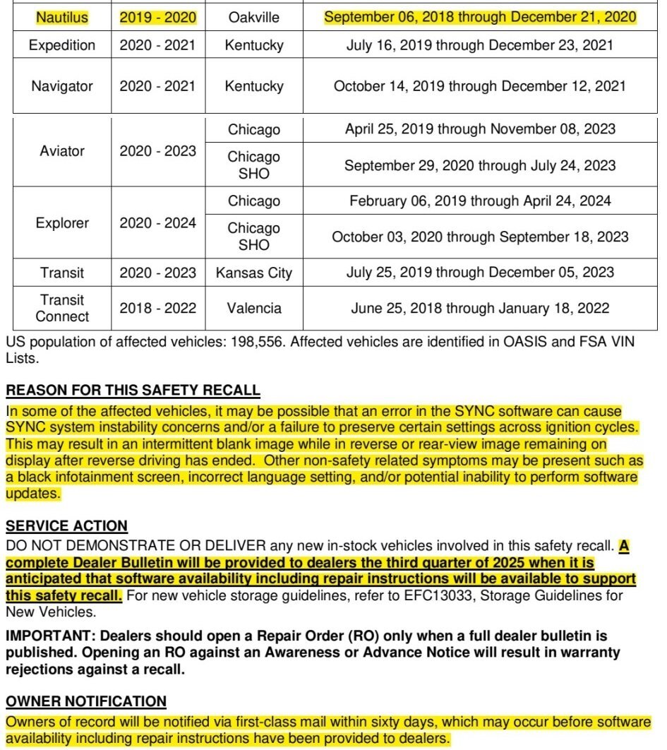

Haz Posted July 3, 2025 Report Share Posted July 3, 2025 *** This is an Advance Notice -- This post will be updated when the Full Dealer Bulletin is released *** 3 Quote Link to comment Share on other sites More sharing options...
Bunky Posted July 3, 2025 Report Share Posted July 3, 2025 I hope all this is a wake up call to Ford (and industry) on improving software quality. Bad software can distract drivers if they try to attempt various actions while driver. It is like an itch you want to scratch. 1 Quote Link to comment Share on other sites More sharing options...
Wubster100 Posted July 3, 2025 Report Share Posted July 3, 2025 Does this mean that SYNC 3.4 will receive another update? Quote Link to comment Share on other sites More sharing options...
