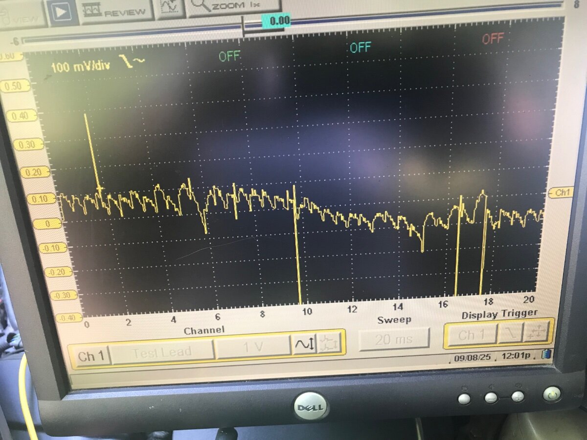

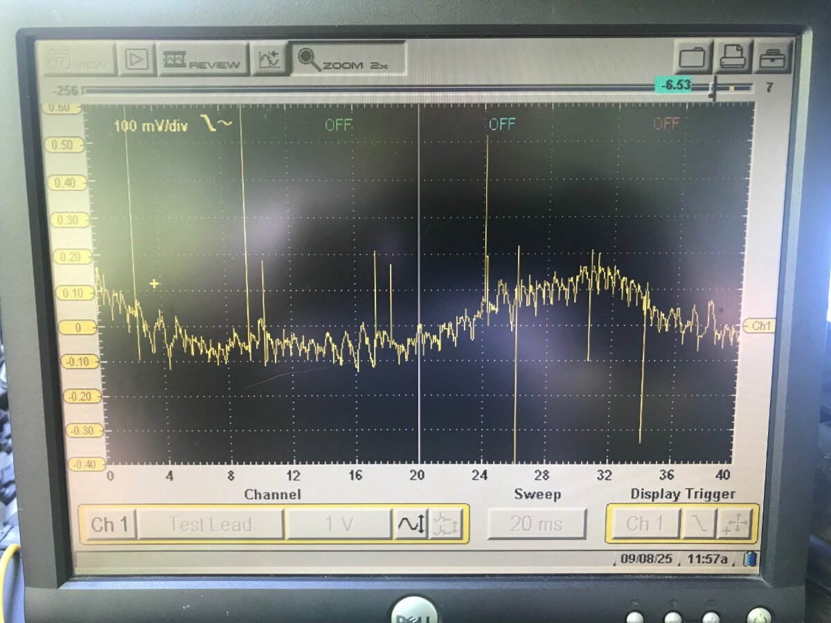

tmise40 Posted September 15 Report Share Posted September 15 Battery drains in two days with just a 0.090mA draw. Pulled the DLC fuse yesterday and it dropped to 0.45mV. None of the other fuses or relays did anything. Other things happening, getting a tpms sensor fault and the rear hatch open button sometimes works and sometimes doesn’t. Replaced the old open button because it was doing the same thing. The battery is less than two years old and checked out ok with a load test. If I can I’ll post some pictures of an alternator ac ripple test with a labscope. Doesn’t look so good to me but see what you all think. 1 Quote Link to comment Share on other sites More sharing options...
