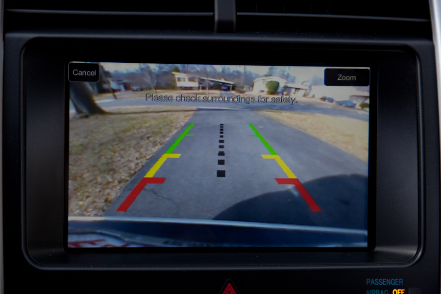

The rear view camera on my Edge is not correctly leveled, when it is you see part of the rear bumper and it is a perfectly horizontal line, so I found myself parking incorrectly, which I never do, so after wondering what was going wrong with me, I found that the camera is twisted a few degrees, so when going reverse, the assist lines show me something that is of course, incorrect. When asked to the service rep at the dealer, he was like. Well, you can totally trust that, it can be like a foot off... which I think is totally BS... how can put something like that to not to be trusted??? Should I demand them to get it calibrated so it is straight? Or is being too picky??
Thanks
well.... took the car in, and after two hours of waiting in there, the answer was, we can not find anything wrong with it.... there i nothing to adjust, and it i just a degree off, which is totally normal, it can be off by a foot (his exact words) manual says that can not be trusted and that you have to use other aids to park too.... which I think is total BS, I have read the manual from start to end several times and it does not say something like that anywhere.
look at the pictures, that this is off by about 20 degrees.....
Now they ask me to take the car on Tuesday for the whole day... what really bothers me is them trying to talk me out of getting it fixed... the technician looks ate me like if I am a crazy moron...

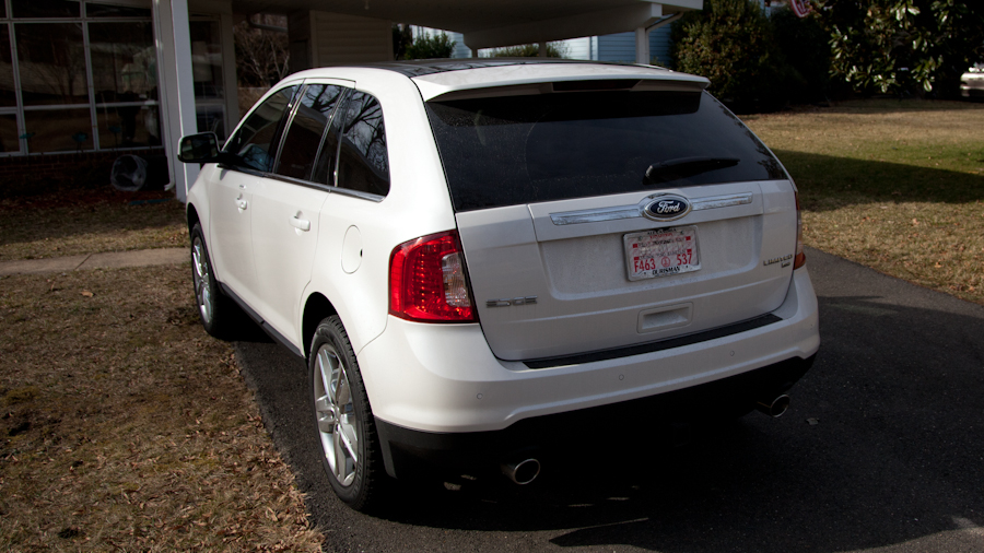

Well.... after two days of leaving my car at the shop.... after they calling me the first day saying that they need another day because the camera was still not straight, and after calling me next day saying that all was perfect.... I'll let you be the judge if it was fixed or not, Look at the pictures and check if you can tell was the before and the after.....
Well... dealer sent me a copy of the chat with their own technical support hotline.... Ford is practically telling...screw you...it is what it is... there is no way to install it in other way.
I guess I will have to do it myself....
