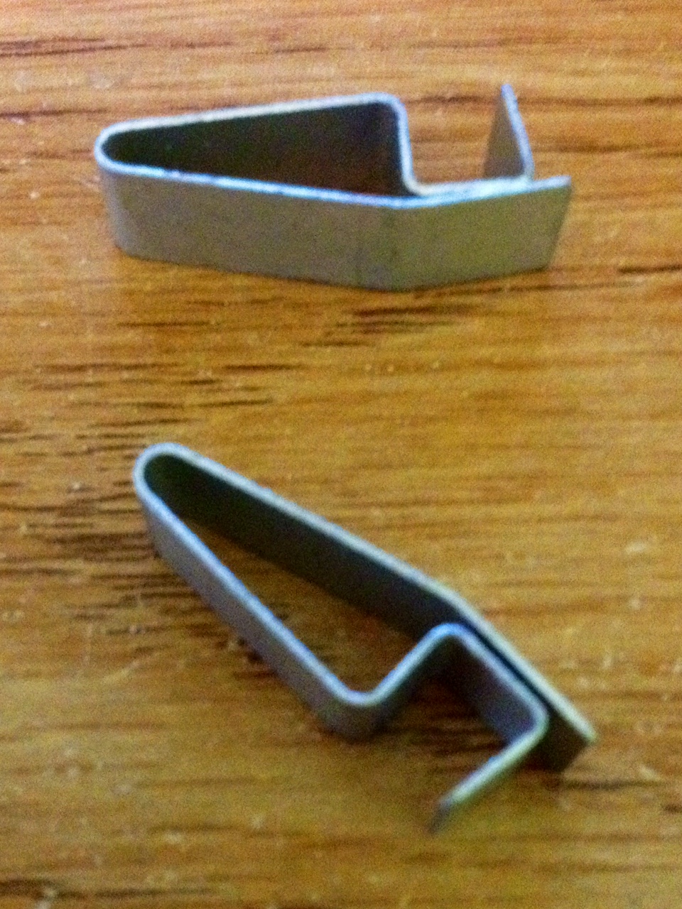

These "Clips" were in the box with the front pads (Powerstop Z23). For the life of me I can't figure where they were suppose to go. The Factory stock Brakes had no such clips. What are they and where were they Suppose to go ?
