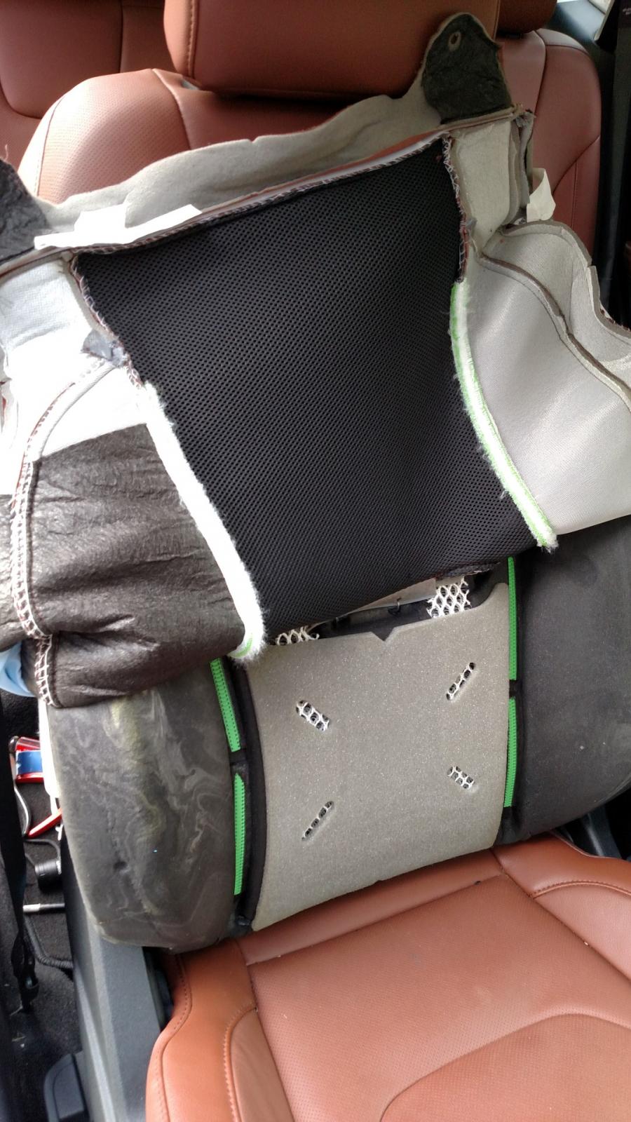

Brian No Zippers on the Edge - Kind of like rolling a condom off. It isn't easy as the fabric and padding is stiff. You can roll it back till you get to side airbag, that gives enough room on the back to access the TED. There is some heavy duty Velcro in the bolster channels where it meets the seat center back that needs to be loosened to get it to roll back. Shows as green in the photo. You can't roll it much higher without getting into the airbags. Just is high enough in the back to access the TED I've attached a picture and a PDF of the notes I sent to Tim when I did mine Paul Seat TED Conversion notes.pdf

The seat covers on an Edge do not unzip. They are "slipped" over the foam seat. You have to peel them off, kind of rolling them back on themselves. There is some velcro tabs on the front side in the seams and once they've been loosened, it peels back a little easier. It's not an easy job but it can be done. I've attached a pdf of the shop manual showing how to do it. Paul Edge_Seat Back blower motor.pdf -

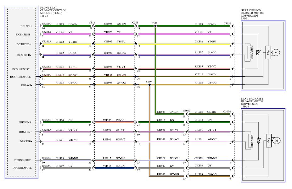

cv27 Your mechanic doesn't know what he's talking about. If he is your resource, you might want to look elsewhere. He's going to get you in trouble. I've attached a clip of the Ford wiring diagram for the drivers seat. Two TED's, with fans. Spend a couple bucks and get the service manual and wiring diagrams from MotoCraft.com to all the naysayers 1) to the sales guys who said the backs don't cool - why'd Ford put a separate TED in the back and perforate the seat. Go back to school on your product. 2) to the mechanics and service advisors who say the bottom gets its cooling from the A/C system - why the TED in the bottom? again, learn your product. Come on people, it's not that complicated. Ford's got a hiccup in their design and they're trying to fix it with the lowest cost impact. But that approach isn't working too well. F150's, Edge's, Explorers. They've got some issues and it is beginning to haunt them. -
