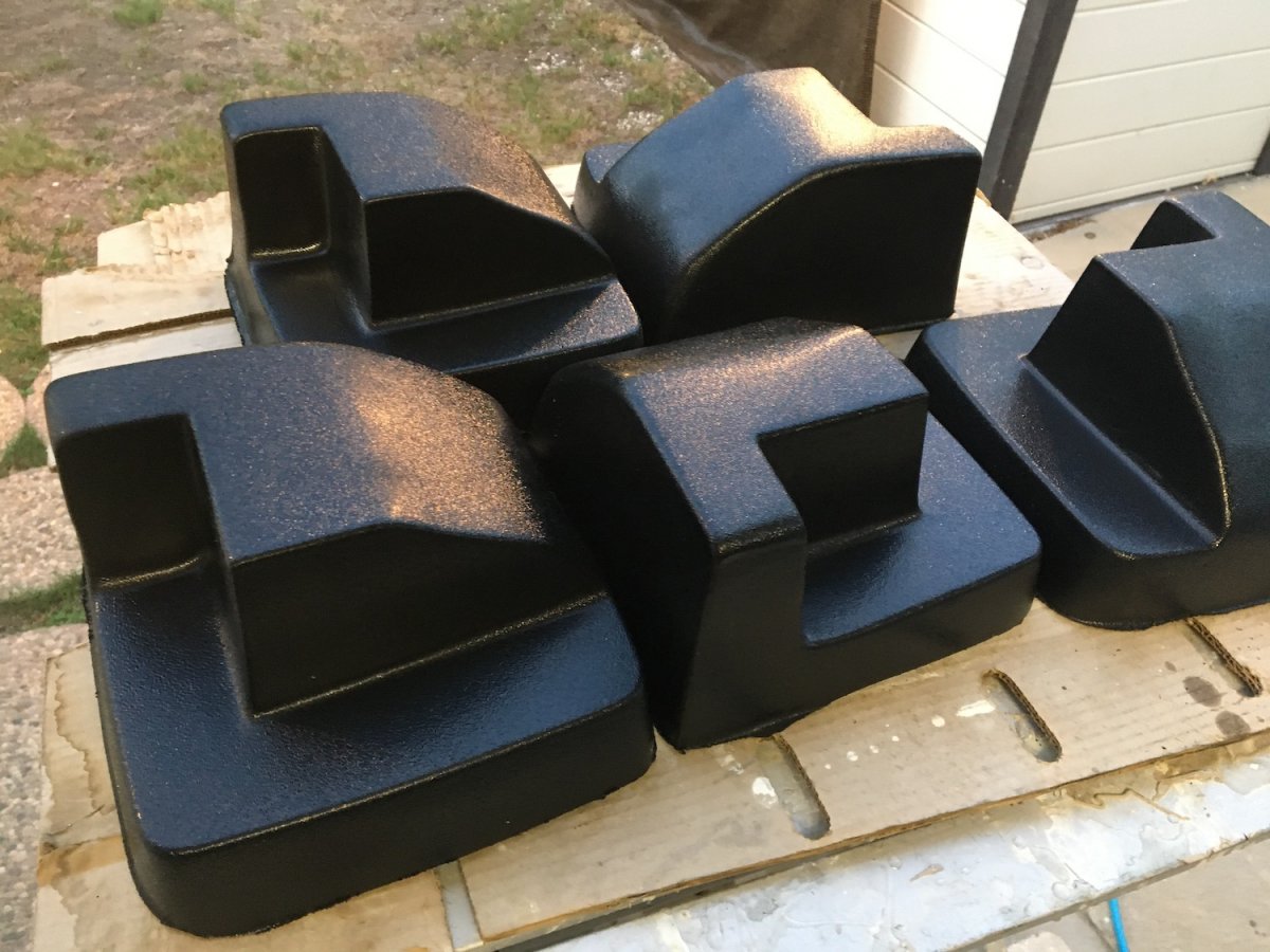

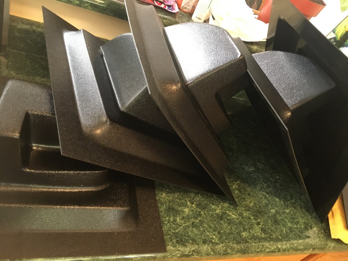

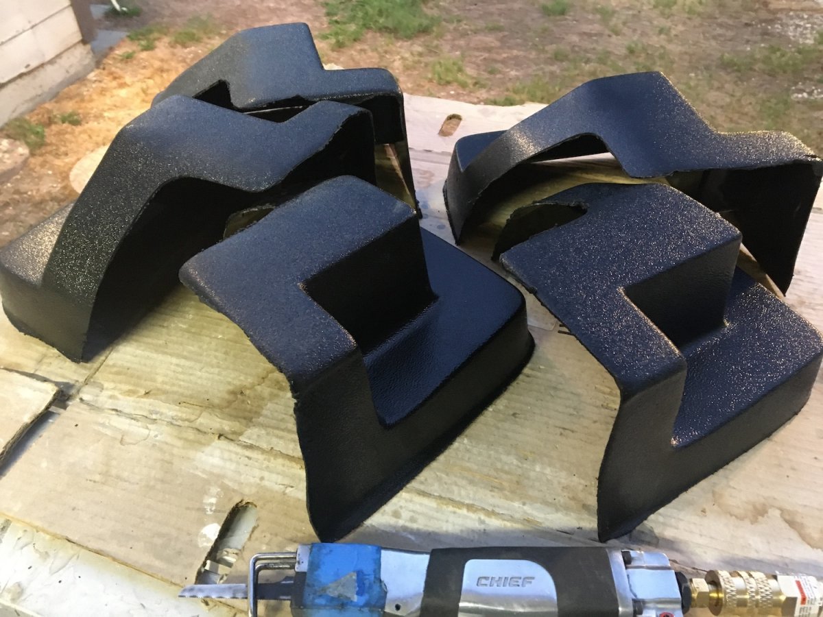

  1. Here are all 5 of the Bottom Patches ready to install. All the holes have been drilled, and used the heat gun to hand form them to their final shape.

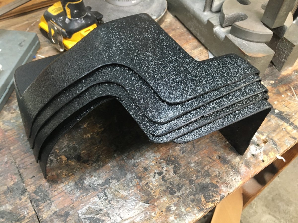

  2. Started the next step in finishing the Bottom Patch. Here I have trimmed and drilled a hole for the feet. After this I will use that heat gun to modify the Bottom Patch to final shape.

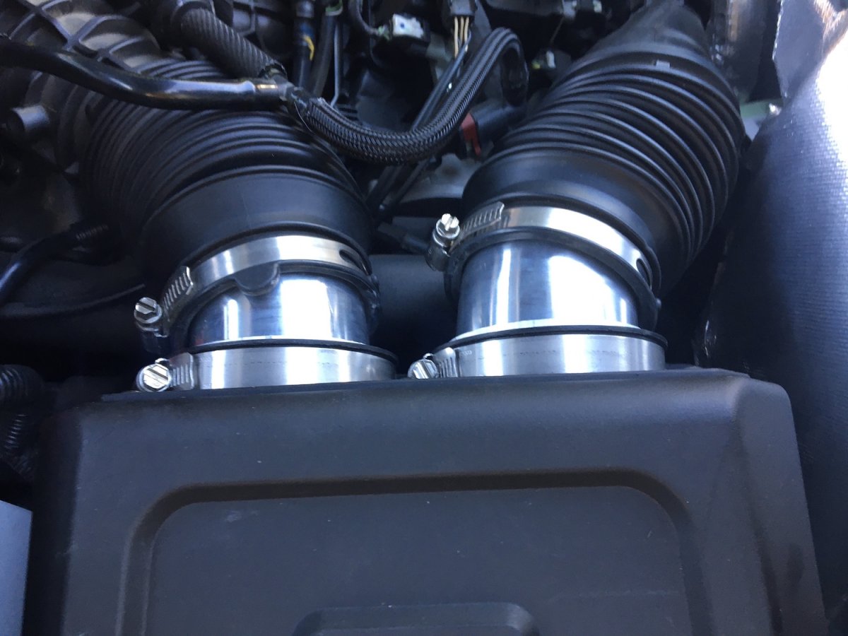

  3. These are the clamps I tested on the Aux Air intake hose. As the hose is corrugated, it turns out that the double wire clamp is best. The double wire clamp applies pressure where the hose touches the tube, and holds tight. The larger SS T-Bolt hose clamp applied pressure at the top where the wire is in the hose, and that allowed the hose to slip off.

  5. JUst thought i should post a daytime photo I tried an expensive SS clamp on the flex hose, but the simple double wire clamp worked best. The car likes the added air but it feels like it could use a tune to get the most from it. If I was to do a resonator delete 2.5 in exhaust system then it would definitely need a new tune for sure..

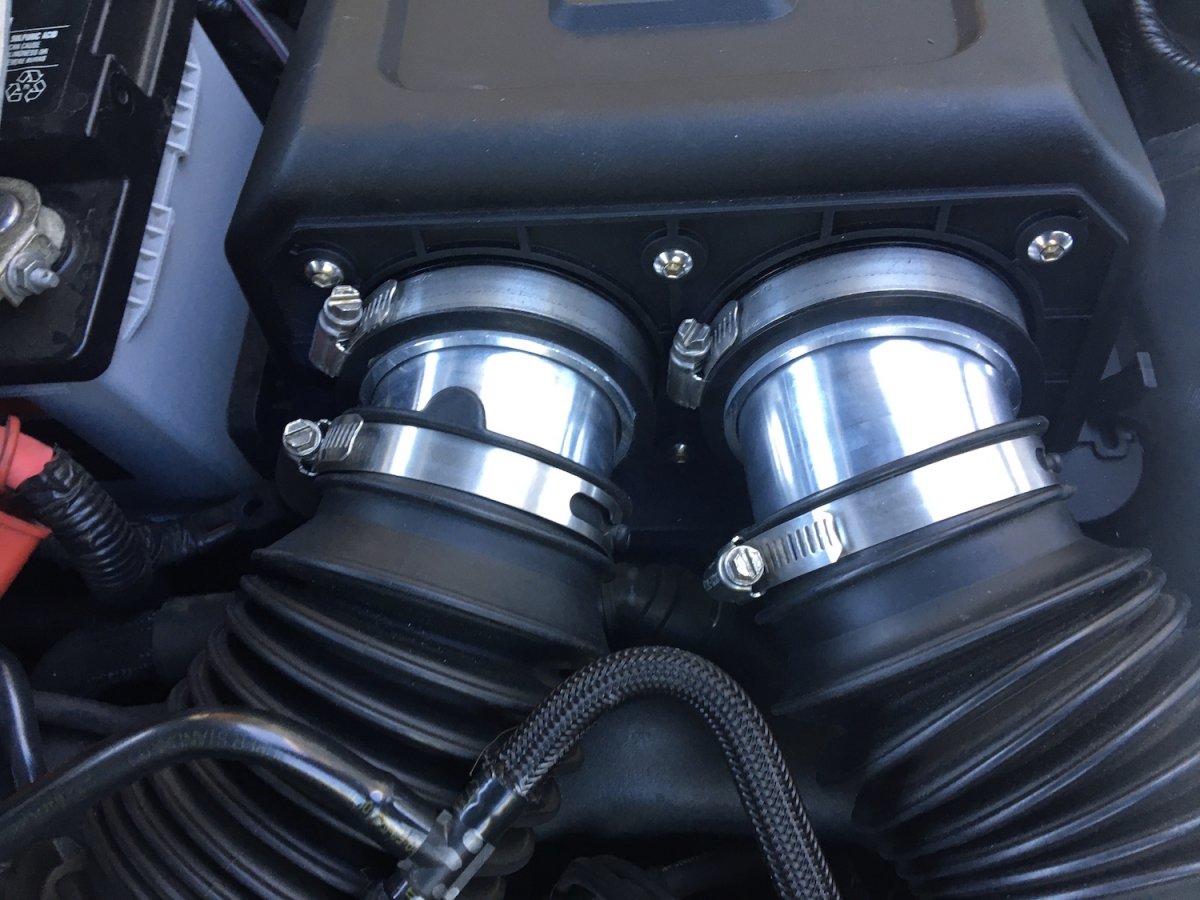

  6. As I said I was on a roll. Decided to remove the V3 and check everything out . The insulation does not have a strong glue on the back and it was coming loose in a couple spots. Otherwise everything checked out fine. I found out some install tricks and also found out you can check the filter with removing the entire unit. As long as I had the top off I decided to try out the other top with the aux air intake on it. Then did a Saturday night test drive,

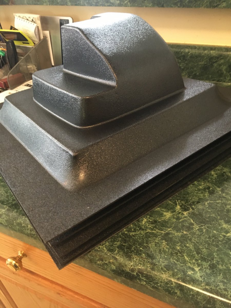

  7. Had just e enough time to cut out the bottom patch. Today was productive and a lot was accomplished. This is going much quicker than I thought . Once the design is locked in, it gets much easier . . . It got dark at 7pm and had to call it a day. I was on a roll. After they are cut out , they need to be trimmed to shape. Next was a trip to the belt sander to clean them up. They still need some more TLC and a big hole drilled before they are ready.

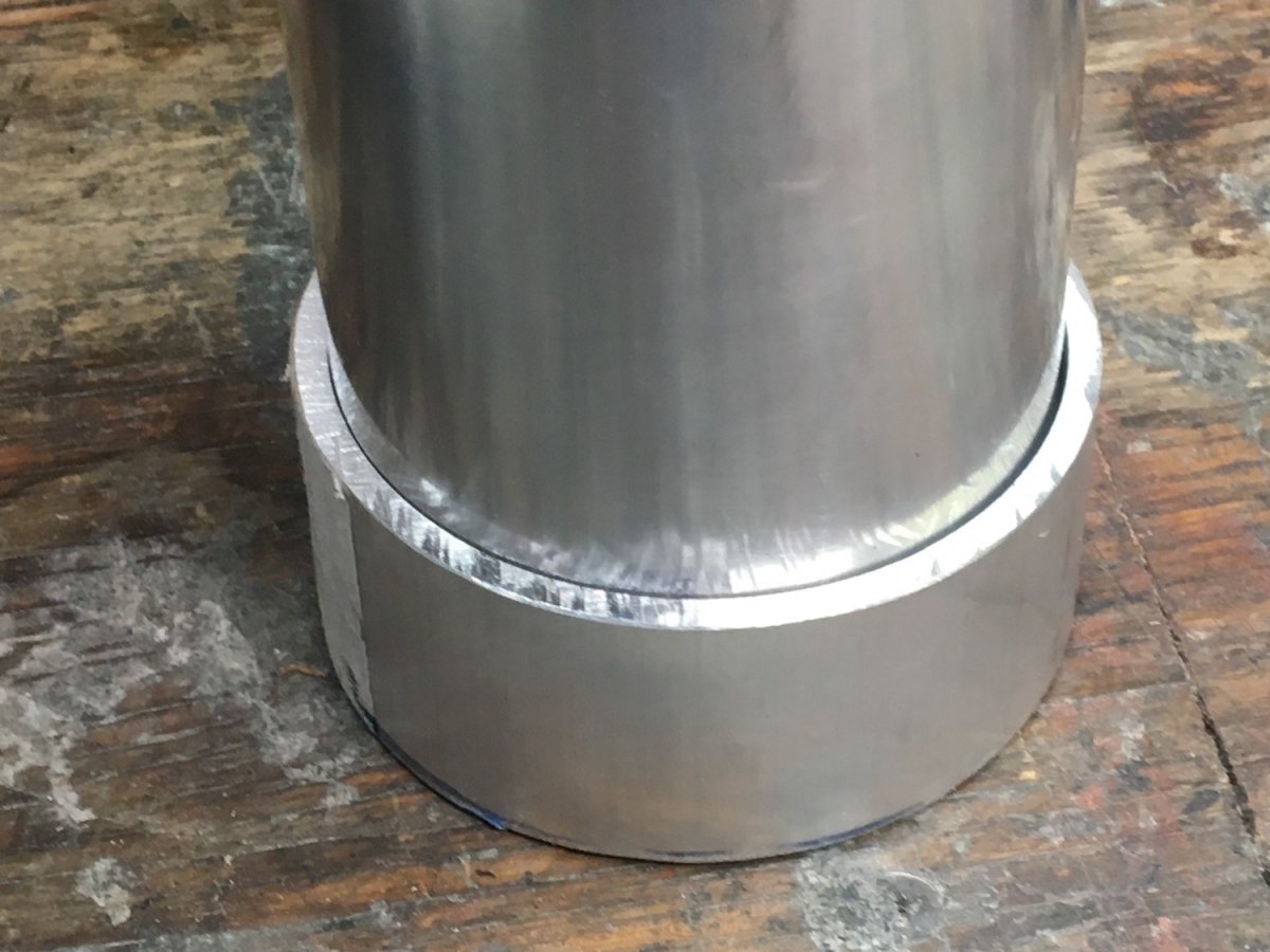

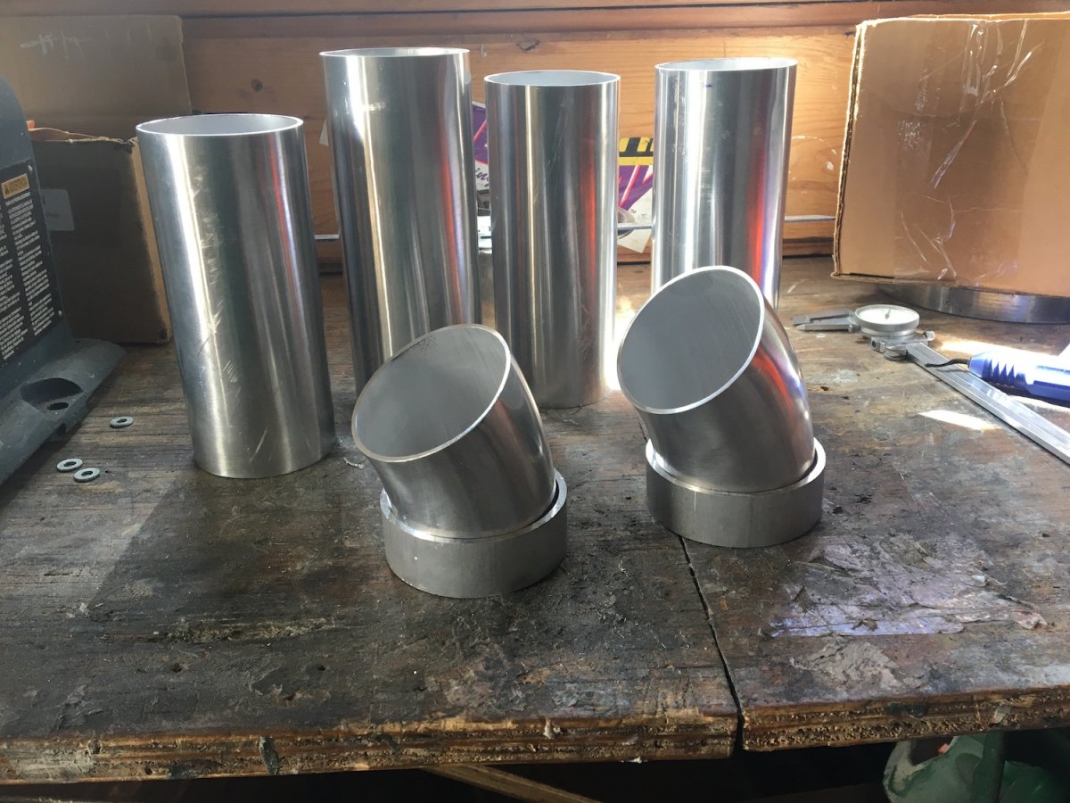

  8. The test fit of the reducer elbows was successful . I was worried that the radius of the bend was too long and would cause a problem, but they fit great ! Now all they have to do is pass the welding test, and if they weld good than I can order up enough to do all five units.

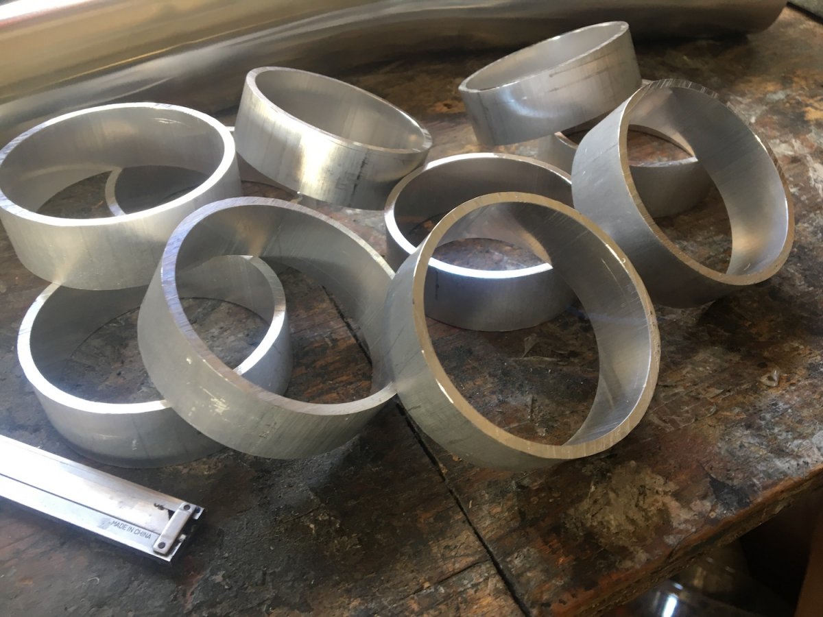

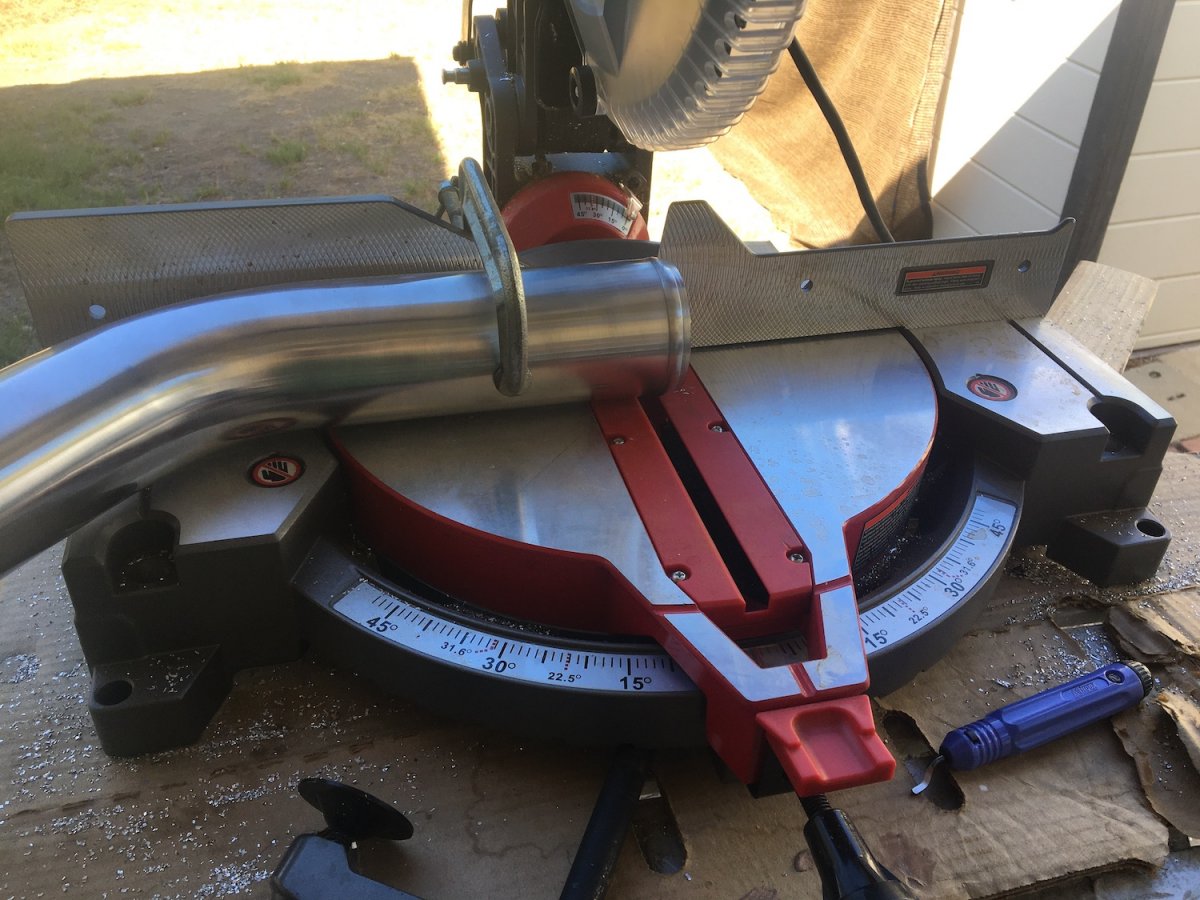

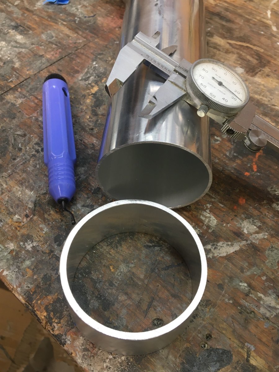

  9. Cut all the collars and trimmed the elbows to the correct length. The hose knurl at the end of the elbow has to be cut off for the tube to lie flat on the saw bed. Here are 10 collars cut to size and de-burred. Thats enough to all 5 V3s. All that is used is the bend of the elbow, the rest is scrap. Here are the two Elbow Reducers ready to be welded. I will test fit them in the car first to see if the radius of the bends works before they are welded.
  10. Not sure what you mean. The difference in the wall the thickness of the elbow is not so much as to cause any problems, and the welds should last forever.

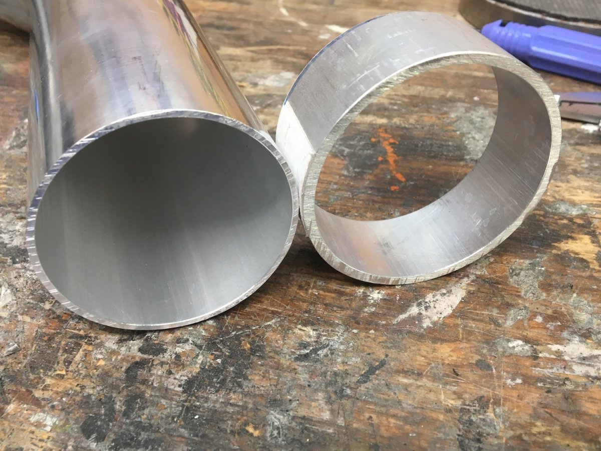

  11. Was able to cut the end of the elbow with ease using the new saw. That saw is going to save me a ton of time.I did this to see the cross section of the elbow tube to get a measurement of the wall thickness, and to test fit the parts together. The collar has to be the correct ID and OD in order to work. The elbow tube OD fits the accordion tubes on the car. The collar fits the filter. They fit together great.

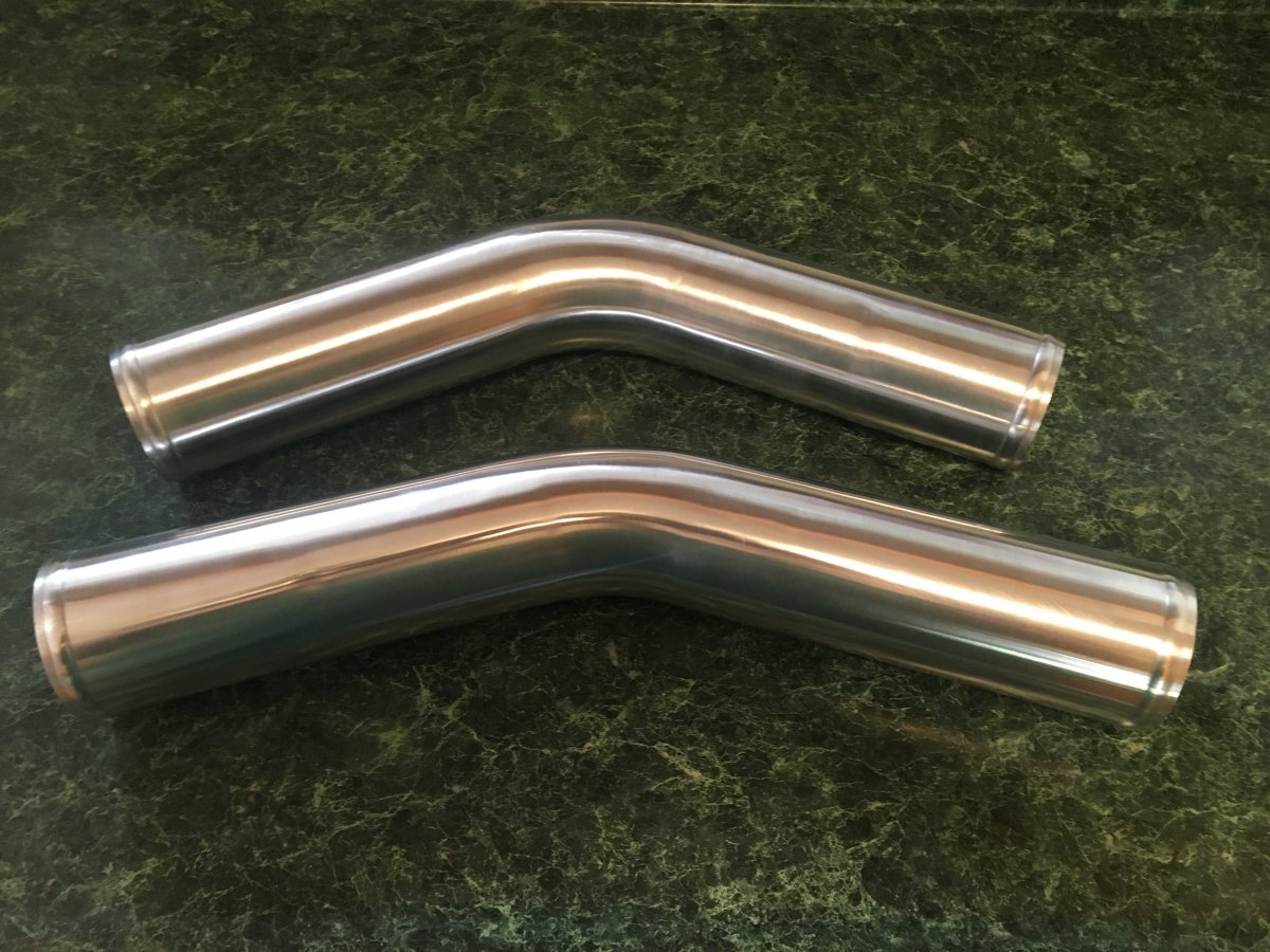

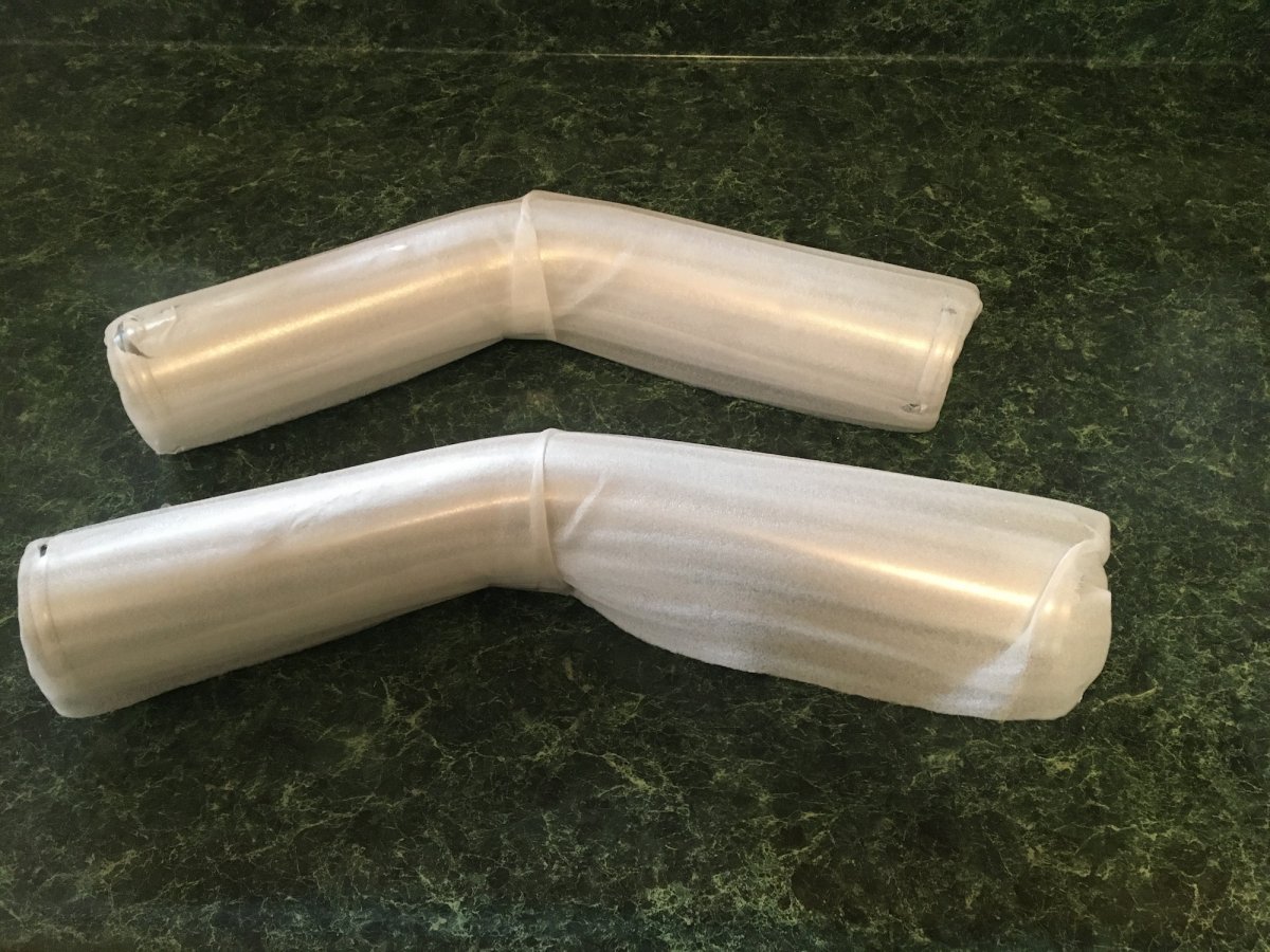

  12. The two aluminum elbows came in today. The shipping was fast and I will make two reducers from these and see if they work .. ( weld and have tight enough radius bends ). The elbows came in these protective wraps. They were protected because they were polished. A nice bonus that means I won't have to polish them after welding. I just have to clean them up. These cost half of what I paid for mine. I really want them to work. They look to be high quality and have thick enough walls to weld. We will all find out soon enough.

  18. Ordered one 35 and one 45 degree elbow today to see if they will work. They are the correct O.D. , and mandrel bent to the correct angle. I don’t know the radius of the bends (need a tight radius) or the weld ability of the aluminum . If they work, they will cut the cost of the reducer elbows significantly.
