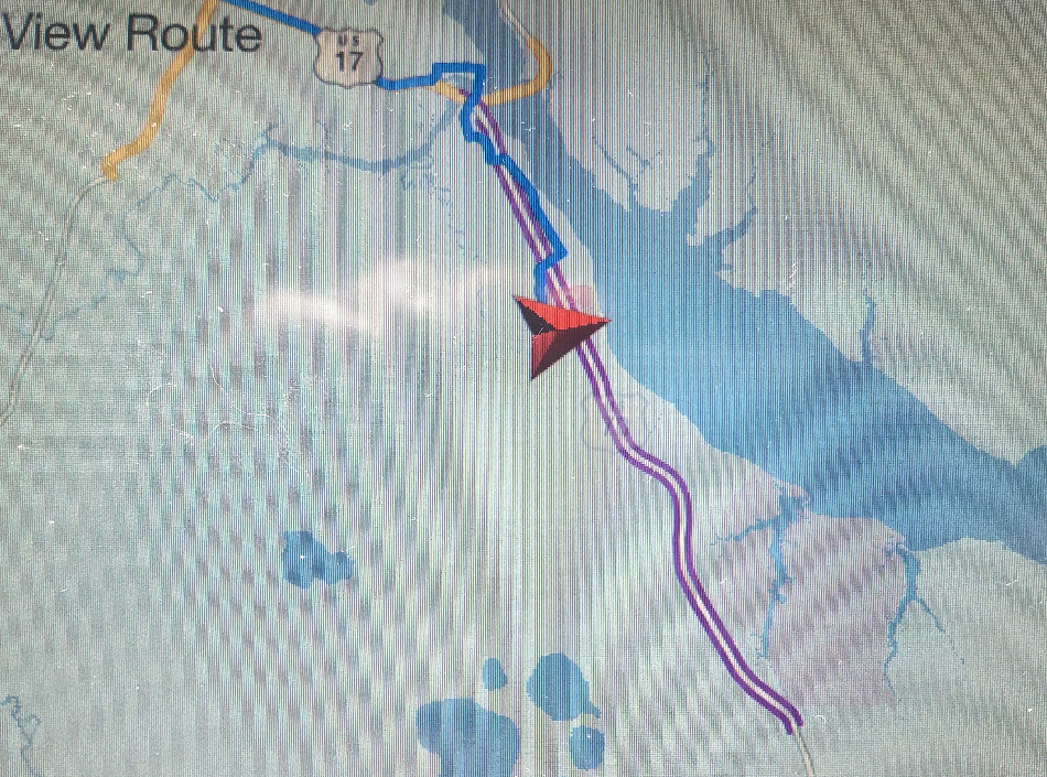

The soft reset made no difference. Then I got online with Sirius. They sent a refresh signal. Still no change. I don't think it is a problem with the car. It is a Sirius problem (no pun intended). Maybe someone else with the Sirius traffic subscription could try navigating from Havelock, NC to Goldsboro, NC, and see if it takes a route other than US70? Check out the two images below. The first one I zoomed in so you could see it taking me all over the place to avoid US70. In the second one you can see that the section of US70 under construction is purple. What does that mean?
None of the above. But I think I have identified the source of the problem. Our Sirius traffic subscription is still active. It appears that Sirius somehow thinks that highway 70 near us is closed. It is under construction but there are no closures. Not even extra traffic (yet ... that is coming). But at no time in the construction will the road be closed. US70 is really the only East-West route in this part of North Carolina. I just performed a soft reset of the system. Let me see if that changes anything. If it does not I think I'll contact Sirius about it. Then ... on to Android Auto.

Coming home from the North Carolina Cedar Island Ferry, the navigation system calculated an unusually long time (almost 3 hrs) to get home in New Bern. Just as a brain check, I set my phone using Google maps to navigate as well. It calculated a reasonable ETA (1:15). For most of the ride the two systems directed us the same way. Since Google had the much shorter time, we kept on the path the phone directed and ignored the car. When I checked on the car for the route, it appeared that it was unaware of the only major road on the route (US 70) and was taking us WAY out of the way to avoid it. Once we got on US 70 in Havelock, I tried to set a new destination, the same one, and it displayed an error that it could not set the new destination. I've never seen this. So right now we cannot trust the Edge navigation. Should I: Reboot the system (instructions are somewhere in this forum I think) Update Sync - I think an update is available which also results in the first bullet Use Android Auto instead which my grandson Andrew insists is far superior Tom
