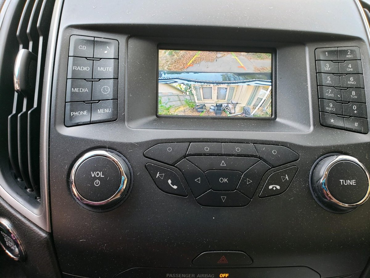

  1. I have a 2016 Edge for 3 years I have had this issue with my backup camera. I have taken it to several dealerships and am still getting the run around. Any suggestions, ideas, or fixes?? Please and thank you!!

      I am no longer under the maufacturers warranty, I am still under my extended warrany. It is 'required' to go back to the puchasing dealership for repairs. I have had it there but they are saying without a 'code' or it constantly doing this, there is no way to diagnose it. I have been to 7 dealerships and have 14+ complaints to Ford Corporate, with no fix! I was hoping I wasn't the only one and someone had a fix!

      Thats cray. What type of extended warranty do you have? I can get my edge serviced in Canada with my extended warranty.
      The view looks magnified. Since it doesn't do this all the time is something hitting the magnification button? I'm sure you are saying to yourself how the hell would that happen with out intentionally doing it.
      Just have to ask. If the view is intermittently magnified I don't see why they cant check the settings, check the module, the wiring, replace the camera etc.

      My 2013 had an upside down picture sometimes and no picture at all sometimes.  I went to Carparts.com and purchased a new camera.  That's all it took.  It works well now.
