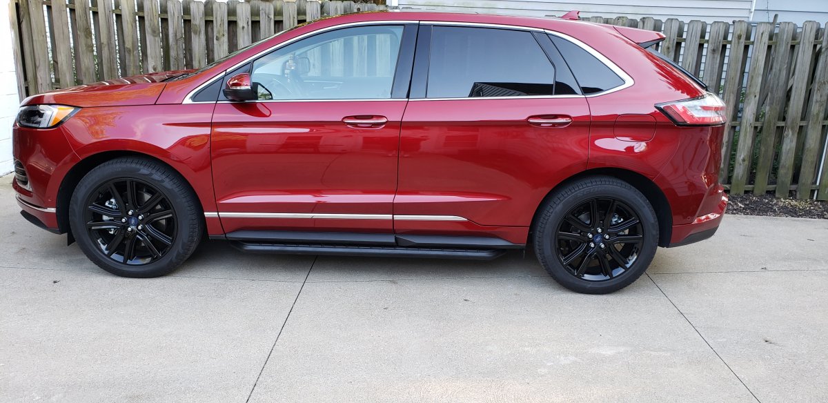

  7. Had the wheels painted and added the running boards.....
  8. Love that Ruby Red on our Titanium
