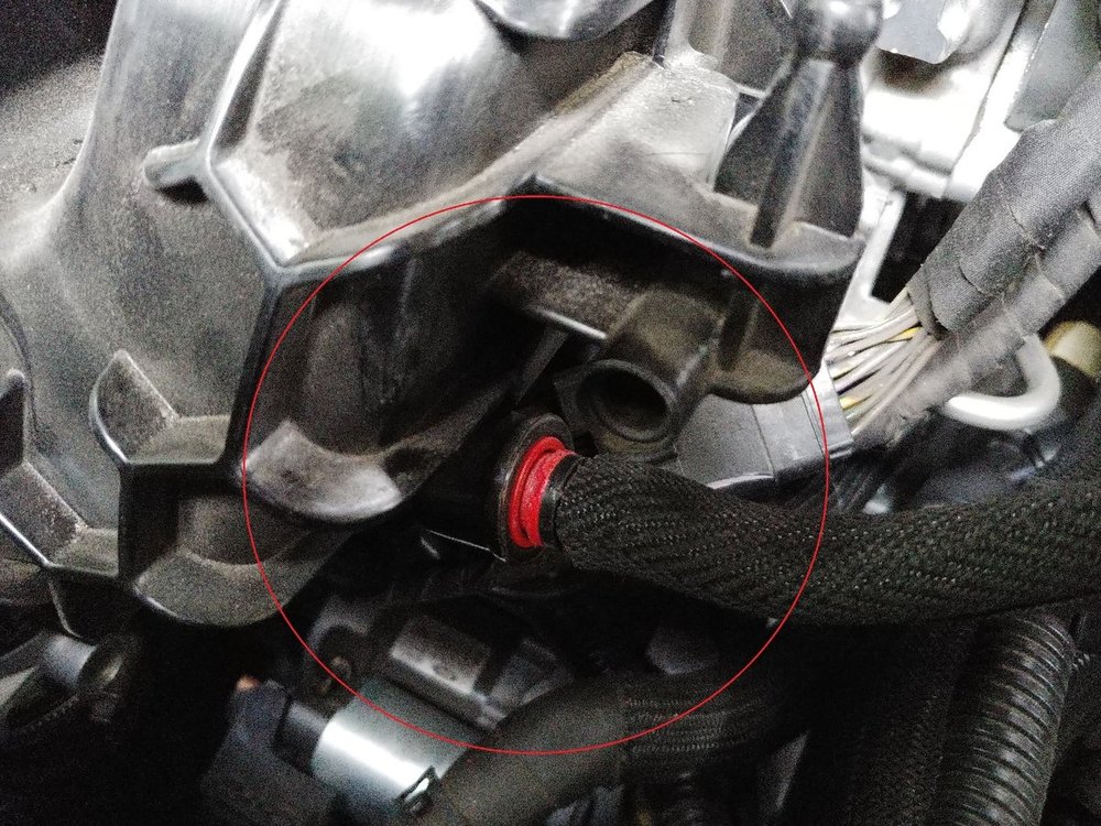

  1. Thanks for the replies you guys. Lildisco, your tip did the trick! It still took a few minutes to finesse it off. Here's a shot of it removed for anyone attempting this in the future.

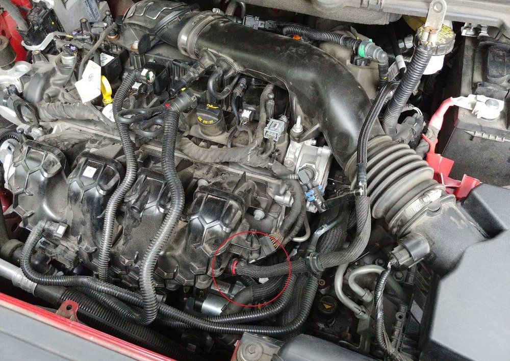

  2. I'm trying to remove the intake manifold to access the fuel injectors on my 2017 2.0L Ecoboost. (the next step in my quest to diagnose a repeated cylinder #2 misfire). The brake booster hose runs into the right side of the manifold & seems to require a special tool for removal, or at least I think so. The coupler is red, round and smooth (there's no clips). Does anyone have experience with this hose/coupler and what it takes to remove it? I've searched this forum and the internet and can't seem to find any mention of it. thanks!
  3. Well would ya look at that! Excellent. Your google doc seems to be restricted. I was able to Google the TSB and eventually find this pdf. https://f01.justanswer.com/hdgene/2a294120-75f1-42ec-ad59-17baaaf9b468_tsb17-0065.pdf I just hope the repair kit it worthwhile.
