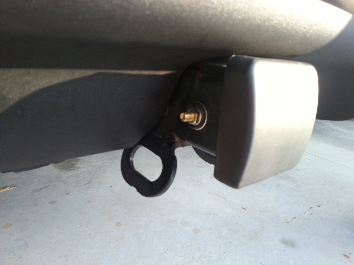

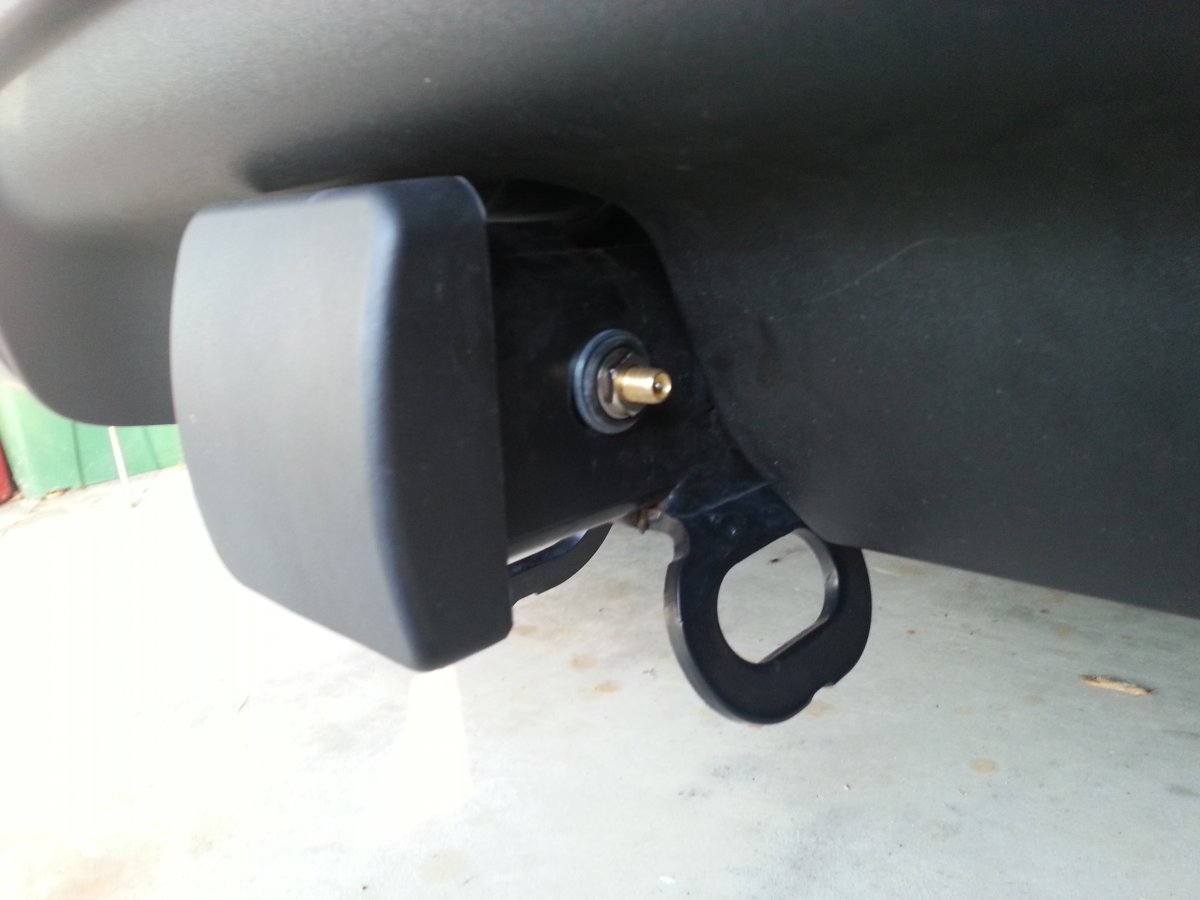

I finally got around to dealing with the wheel hop on the right rear axle and tire today. I know that a lot of 2.7 edges have also had the same problem. From what I have read on these forums some have remedied the problem by replacing all of the coil springs which also lowered the car then put tires with better traction on all four corners.. I did not want to lower the car so I decided to try a different solution. Being an old timer I remember many of the original muscle cars in the 60's&70's had coil spring rear suspensions and suffered from wheel hop. Many of the racers put Air Lift air bags inside of the rear coil springs then played with the the pressure in the bags until the the wheel hop stopped. Today it took about 2 hours to install the air bags then run the air lines and it was finished.Anyone with a jack that can lift both rear wheels and 2 jack stands can do the job. The kit comes with everything that is needed to complete the job. The air inlet valves need to be placed in a location that will allow you to put air in & out of the bags easily. I ran the air lines from the bags into the trailer hitch receiver then used the holes on each side of the hitch receiver where the hitch pin goes. Put the inlet valve for the left bag on the left side of the hitch and right side on the right. After the install I took the car out and tested it.I made 2 starts on concrete and 3 on asphalt and although I had wheel spin there was not a hint of wheel hop.I started with 5.5 lbs in the left side and 15 lbs in the right.Typically you will need more pressure on the right. I will play with it a little more in the next couple days. Cost is $100 for the bags and I would guess install would cost about the same. If you go this route you might save enough by not buying springs and paying for the install to pay for a set of High Performance Tars. I'm just sayin You pays your money and ya takes ya choice! Part #60785

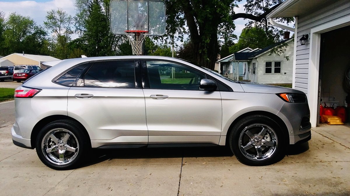

I decided to put some custom wheels on the ST. Being old school I wanted a 5 spoke chrome wheel and after looking around the internet I found these on Ebay.
