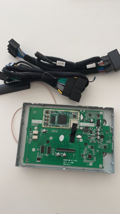

  4. Hi losteaglescout , post some pics so I can see the problems. Than maybe I can help you from my experience. about steering control, I found out the if I choose as input device Bluetooth streaming, all the controls are operating as expected. Vol up and down, seek, answer phone calls etc’ after 1 year with the upgrade, I’m super happy with the viskoo. Working perfectly
  5. Hello to all, yes, I bought the kit and the installation was simple and without any issue. as for steering wheel control, only volume buttons working. (Edge eco boost 2014 sel+) as soon as you understand that you have Siri on board, it’s not a problem at all. highly recommend upgrade
