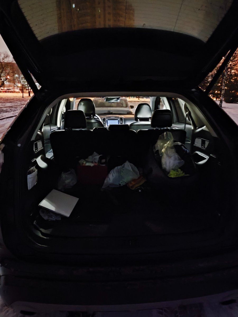

The door ajar indicator comes on when the vehicle's system detects that one of the doors (in this case, the rear door) is not closed securely. How can I temporarily disable it?

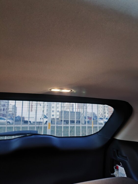

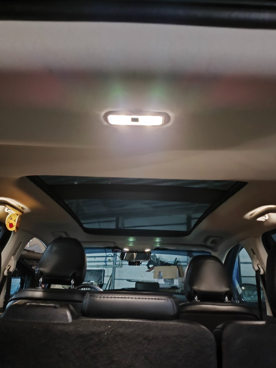

Car High Brightness Trunk Lighting Ambient Light Interior Decoration LED Wiring Free Automatic Sensing Tailgate Light Strip
There is a solution that is easier to implement. https://trusttosell.com/shop/car-high-brightness-trunk-lighting-ambient-light-interior-decoration-led-wiring-free-automatic-sensing-tailgate-light-strip/
