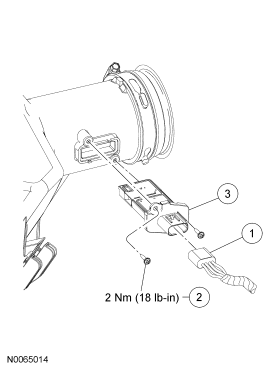

At this mileage, the Edge would benefit from a spark plug and PCV valve change (is DIY-able). Switch to High Mileage oil if available. Clean the MAF sensor (sits in the pipe attached to the air cleaner box) thoroughly with MAF cleaner (not brake cleaner or carb cleaner, etc). Having the ignition system (coil on plugs specifically) checked is also a good idea, don't want a bad PCM frying the coils or vice versa.

So the only error pointed to an intake sensor? Can you post a list if you have it? Or get a code reader and read the codes/have an auto store read them for you for free. Otherwise it's pure guesswork on our part. A MAF Error code would look like this:
P0102 Mass Air Flow (MAF) Circuit Low Input

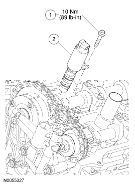

I assume the solenoid being referred to is the Variable Camshaft Timing (VCT) Oil Control Solenoid. An important part of the timing system of the engine.
Variable Camshaft Timing (VCT) system
The VCT system changes intake camshaft timing dependent on engine speed, load and oil temperature. Oil pressure advances and retards camshaft timing to improve low and high speed engine performance, engine idle quality and exhaust emissions.
You do have to remove the valve covers to replace the solenoids (1 per bank), and that would be a good time to replace plugs/PCV valve since they'd be fully exposed in the process. Do the valve covers have any leaks? That could be caused by pressurization of the PCV system which could be caused by a sticking PCV valve.

After the solenoid was replaced the problem persisted so he continued to work on my edge. Finally, he found out that it was a problem with the VCT cam phaser. He told me a close friend of his (who specializes on fords) was very knowledgeable and had specialized tools for the labor and could work on her. Will drop her off tomorrow morning so he can take a look. The first mechanic strongly recommended this new technician, as he works on many ford fleets from companies.

Cam phasers are an in-vehicle repair so no, the engine does not need to be pulled out. The timing cover does come off during this process, so I would have the timing drive components including chains, tensioners, etc. replaced at the same time. There are 2 cam phasers, 1 for each bank of the engine, and both should be replaced at the same time.
