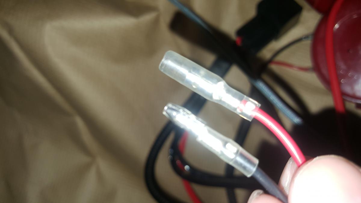

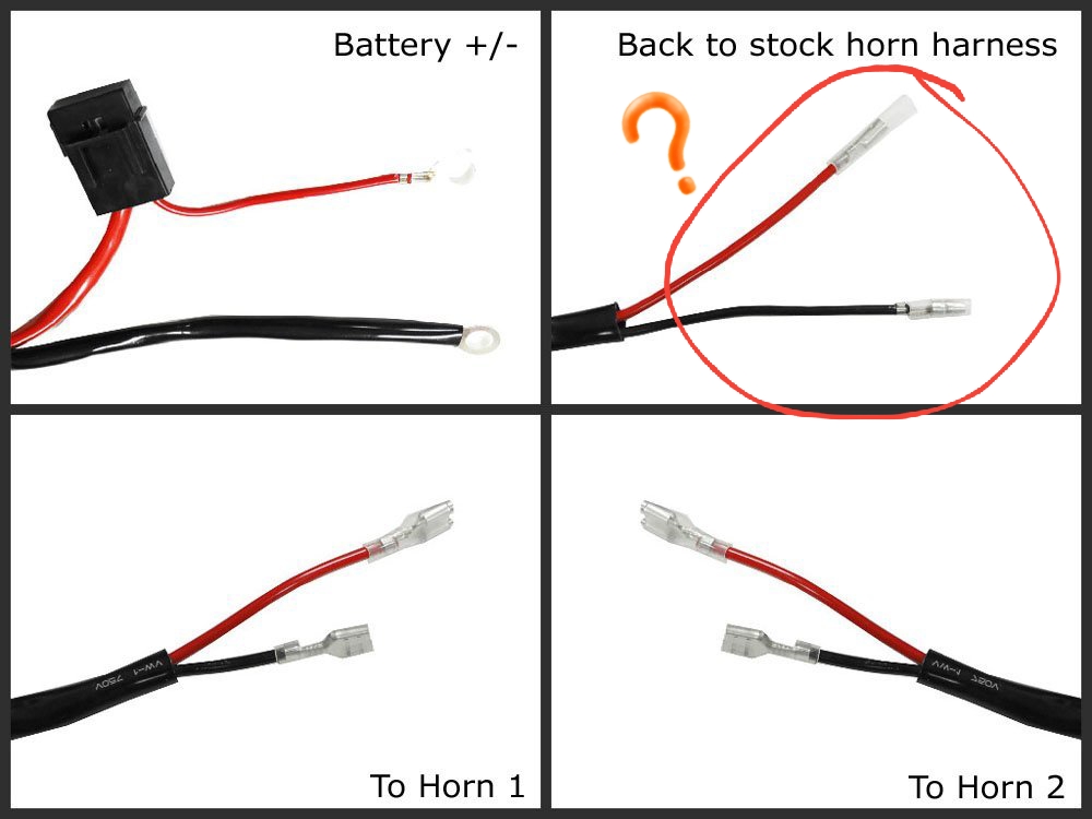

Bryce Ostrander Posted August 5, 2017 Author Report Share Posted August 5, 2017 I have connected everything except the circled area I don't know what that goes to Quote Link to comment Share on other sites More sharing options...
Bryce Ostrander Posted August 5, 2017 Author Report Share Posted August 5, 2017 Forgot to attach the picture Quote Link to comment Share on other sites More sharing options...
Bryce Ostrander Posted August 5, 2017 Author Report Share Posted August 5, 2017 Well go clarify I know it should go back to the stock horn harness but I don't know how to connect it Quote Link to comment Share on other sites More sharing options...
Brucifer Posted August 5, 2017 Report Share Posted August 5, 2017 In order to complete the circuit on my relay, I needed to connect each side to each wire coming from the harness to the horn. Quote Link to comment Share on other sites More sharing options...
Bryce Ostrander Posted August 5, 2017 Author Report Share Posted August 5, 2017 I don't know how to connect this to the stock wiring harness Quote Link to comment Share on other sites More sharing options...
Brucifer Posted August 9, 2017 Report Share Posted August 9, 2017 I don't know how to connect this to the stock wiring harness You will either have to splice it in right down where the horns are (which means maybe running an extension line from your horn harness), or try and trace those wires back to a point where they are close enough to tap into. Wires will be cut or exposed to make any option happen. Another, more involved option is to visit your local Pik-n-Pull to see if you can find another Edge with the same stock horns. Take the pigtail off that and tie your horn harness into that. They should give you the extra wire length to make thing simpler to solder and if the new horns are not your thing, you can easily replace the original stock horns. Quote Link to comment Share on other sites More sharing options...
