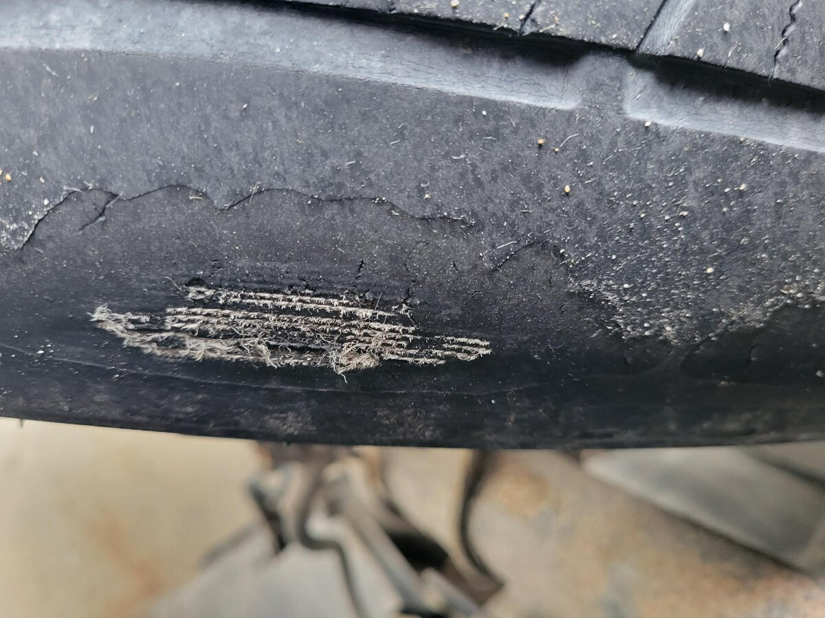

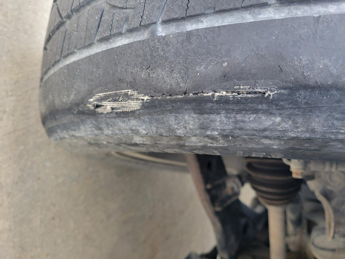

ebodell67 Posted October 2, 2025 Author Report Share Posted October 2, 2025 Found a bad tire on the right front. So I am trying to get a couple used tires to get me through the winter. I will try and align the front end a bit but it is pretty worn out. Found a couple of used tire places close to work will see what they have. I pulled the tire last night along with and worst of the remaining three. I hope to get a couple decent ones to run on the front. May explain the howling noise that was getting worse as the carcass was starting to separate. Wanted to hold off a few more weeks before I got tire but alas that plan has changed. Quote Link to comment Share on other sites More sharing options...
edgeidiot Posted October 2, 2025 Report Share Posted October 2, 2025 As an old tire salesman, I beg of you to measure the remaining tread depth on the other three tires. The picture above shows that there is an alignment issue AND the tire is down to the wear bars. You are gambling the life of not only yourself, but your wife and others on the road with tires like this. A tire in this condition would not pass a state inspection. Even the cheapest Chinese tire would be better than continuing to drive if your other tires are also worn out. Quote Link to comment Share on other sites More sharing options...
ebodell67 Posted October 2, 2025 Author Report Share Posted October 2, 2025 2 hours ago, edgeidiot said: As an old tire salesman, I beg of you to measure the remaining tread depth on the other three tires. The picture above shows that there is an alignment issue AND the tire is down to the wear bars. You are gambling the life of not only yourself, but your wife and others on the road with tires like this. A tire in this condition would not pass a state inspection. Even the cheapest Chinese tire would be better than continuing to drive if your other tires are also worn out. It is completely an alignment issue. The outside of that tire is not down to the wear bars. The other three, while not worn perfectly even, have some life left in them. I just bought two used tires, mounted and balanced for $100 total. I will keep an eye on the right front now I see that I have a problem and rotate every oil change. Am I going to align the front? Nope. I will make a couple of adjustments on the camber to see if I can pull some of the negative out of it but that is it. I will put the two new ones on the front and run it. Was the tire dangerous, yes of course it was. As soon as I saw it I parked the car and switched to the chore truck. Quote Link to comment Share on other sites More sharing options...
enigma-2 Posted October 2, 2025 Report Share Posted October 2, 2025 Think I'd check the tie rod ends, ball joints and wheel bearings, as well. Often times there's more going on than just being out of alignment due to hitting a pot hole. Quote Link to comment Share on other sites More sharing options...
