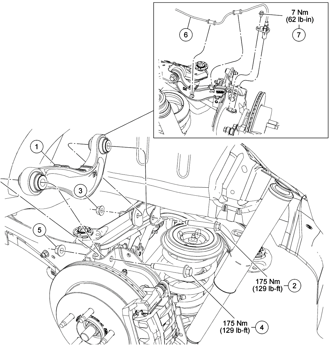

mindreeze Posted Wednesday at 04:36 PM Report Share Posted Wednesday at 04:36 PM Hi y’all I’m trying to find proper procedures on replacing my rear upper control arm. I’ve look everywhere and nothing… I’d appreciate the help offered… Quote Link to comment Share on other sites More sharing options...

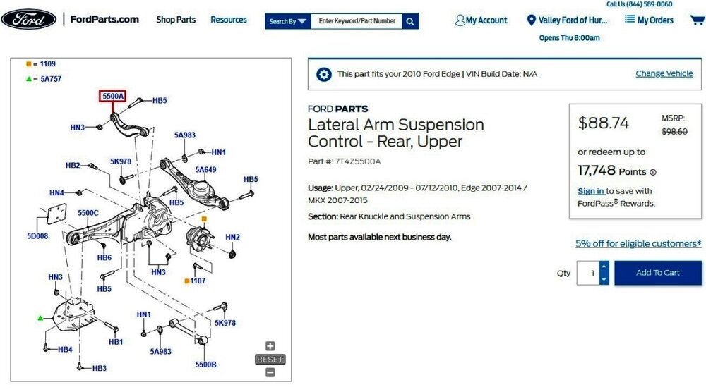

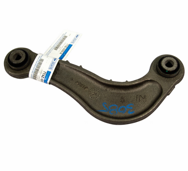

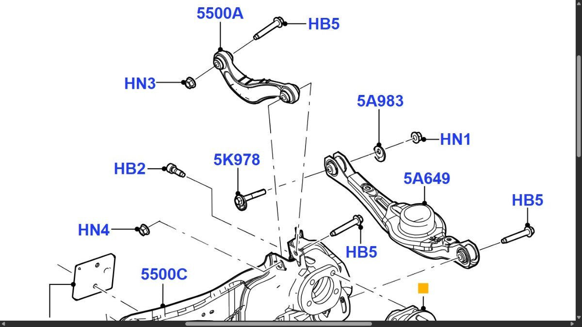

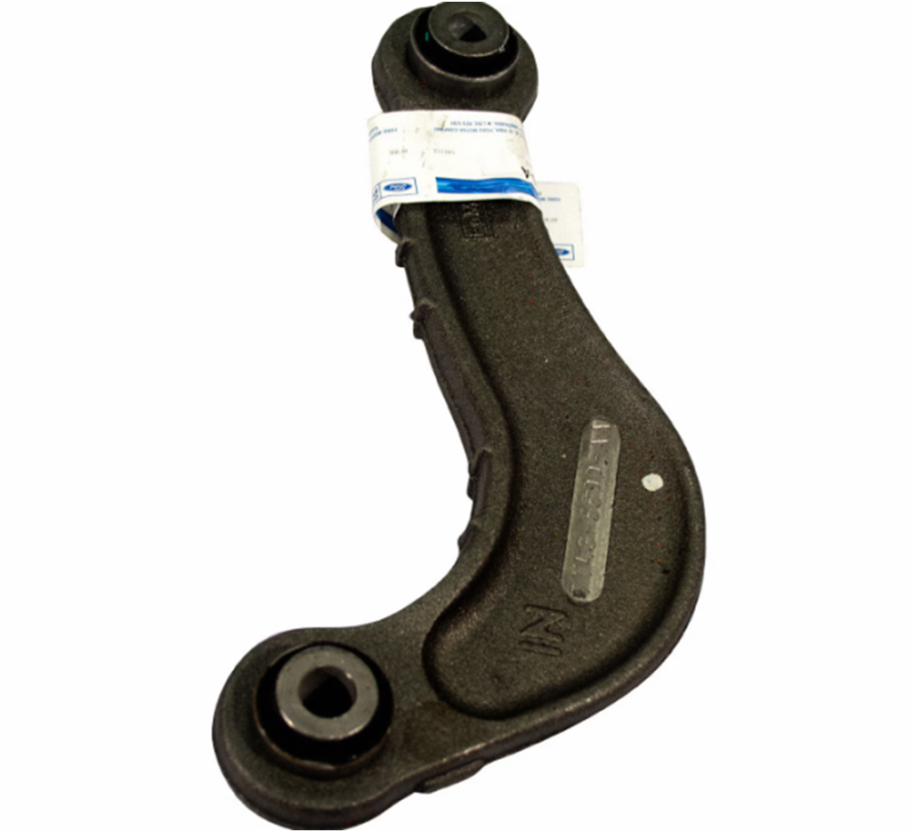

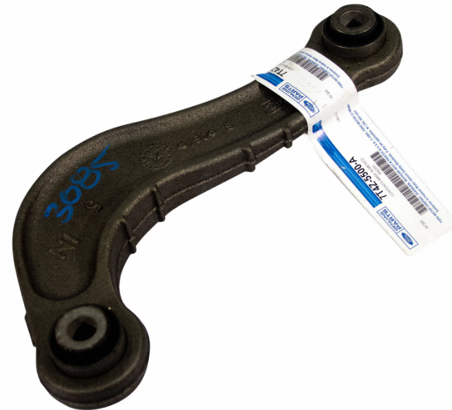

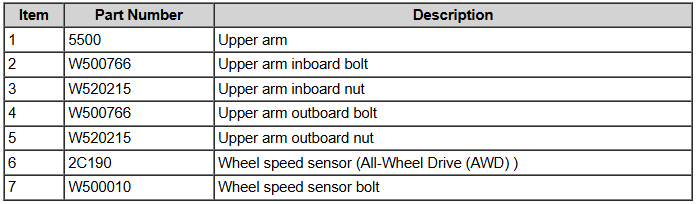

Haz Posted Wednesday at 10:40 PM Report Share Posted Wednesday at 10:40 PM (edited) The following illustration is part of the rear Upper Arm removal and installation procedure from the 2010 Edge Workshop Manual, which is attached below as PDF document... Link to this FordParts webpage Link to this FordParts illustration, which is scrollable and zoomable in your browser Rear Upper Arm photos from FordParts,,, Good luck! Upper Arm -- Rear Suspension - Removal and Installation - 2010 Edge Workshop Manual.pdf Edited Wednesday at 10:44 PM by Haz 1 Quote Link to comment Share on other sites More sharing options...
