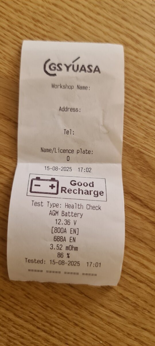

Beyondonedge Posted August 15 Author Report Share Posted August 15 Update: This morning it happened again. Interestingly, I drove with the windows down (I had to, too hot) and it sorted itself mid-drive. However, I go back to the car after work and it has been like that since. I had a bit of time so took it to halfords to check the battery but they said it was good (see photo). I guess next step try replacing FCIM? Quote Link to comment Share on other sites More sharing options...

enigma-2 Posted August 27 Report Share Posted August 27 I'd still have the battery tested. I say this as you're getting multiple malfunctions at the same time (low voltage can cause unrelated errors.) By the looks of it, they used a voltage test. Voltage tests were ok years ago when a car didn't rely the heavy use of electronics. Low voltage, no problem. Butbin a computer, low voltage.. and the microprocessor is making up zeros for ones. You need to test the CCA rating of a modern battery. Battery's can test full voltage but still not be able to deliver enough current when under stress Here's what I use to test my batteries (I even use it for my Simplicity garden tractor): https://a.co/d/5DF64x3 It's a little more expensive, but it also tests the charging system as well. Quote Link to comment Share on other sites More sharing options...

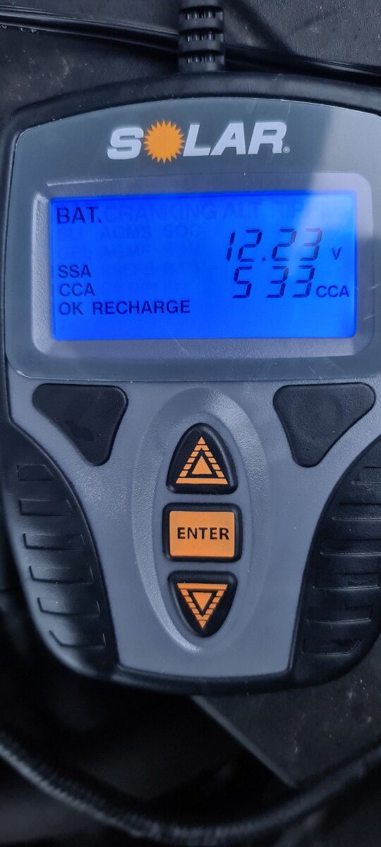

Beyondonedge Posted September 14 Author Report Share Posted September 14 Hi. I finally got round to testing the battery with the tester you recommended. I have a photo of the result. I guess this means it is good? Any further ideas? Now that there is no hot weather there is no way to recreate the conditions to check if any solutions work; which is annoying. Quote Link to comment Share on other sites More sharing options...
enigma-2 Posted September 19 Report Share Posted September 19 What CCA is your battery rated at; was it 650 CCA? Quote Link to comment Share on other sites More sharing options...
Beyondonedge Posted September 20 Author Report Share Posted September 20 I believe 800CCA. That is what I put in the settings to test. Quote Link to comment Share on other sites More sharing options...
1004ron Posted September 20 Report Share Posted September 20 (edited) I'm guessing that tester has the same capabilities as mine, which is the CCA, Cranking Amps, and Charging System - if so the best to perform all those tests. Odd that the CCA will drop that much from Aug to Sept ?? The settling voltage is lower than it should be - good reason to use the tester for charging rate. 12.23V is about 65% charged. Edited September 20 by 1004ron Quote Link to comment Share on other sites More sharing options...

Beyondonedge Posted September 21 Author Report Share Posted September 21 Hi. So I did all the tests I could. I started off with another CCA test, then Cranking test, Charging system test, Ripple test. At the end I did another CCA test and noticed it said 661 from 636 at the beginning. Not sure if that is good or not. Would a few minutes of engine running make such a difference? Quote Link to comment Share on other sites More sharing options...
1004ron Posted September 21 Report Share Posted September 21 That's all looking good - battery isn't new, but not near replacement time. The settling voltage of 12.23V is possibly an indication of a parasitic draw - I'd do a test for that - many YT vids on that. Doesn't explain the intermittent operational issues - that may need expert diagnostics and probably need to to misbehave at the time. Quote Link to comment Share on other sites More sharing options...
