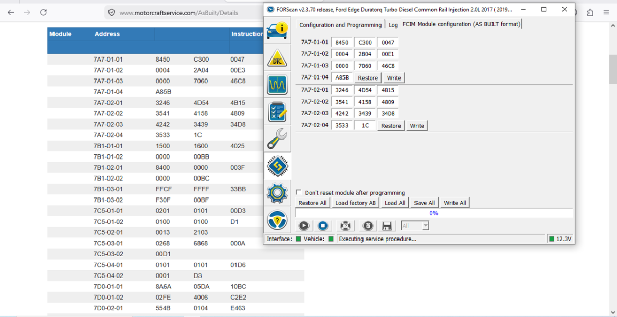

Beyondonedge Posted June 27 Author Report Share Posted June 27 Today I realised there is no way to read the FCIM data or its DTCs while the issue is present; an error appears in Forscan (therefore no power?). So I waited for the issue to go before doing a read and taking a picture so I can code the replacement FCIM. I haven't swapped it yet. But I compared the Asbuilt values to the ones from the ford site and noticed they are not the same. I am curious what you make of that and if it is of any significance. Quote Link to comment Share on other sites More sharing options...
