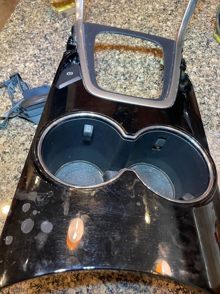

Cobra4fun Posted 21 hours ago Report Share Posted 21 hours ago (edited) So I took my cupholder apart on my wife’s 2018 Ford Edge because the beverage retention tabs weren’t working and loose. I found out that the clear colored rubber band had come loose that pushes IN all the retainers to hold beverages in the cupholders. Does anybody have pictures or a diagram of how this clear rubber band is supposed to be routed around the cup holder retention tabs??? It looks like it goes around every tab twice at the top and bottom Edited 6 hours ago by Cobra4fun Update Quote Link to comment Share on other sites More sharing options...

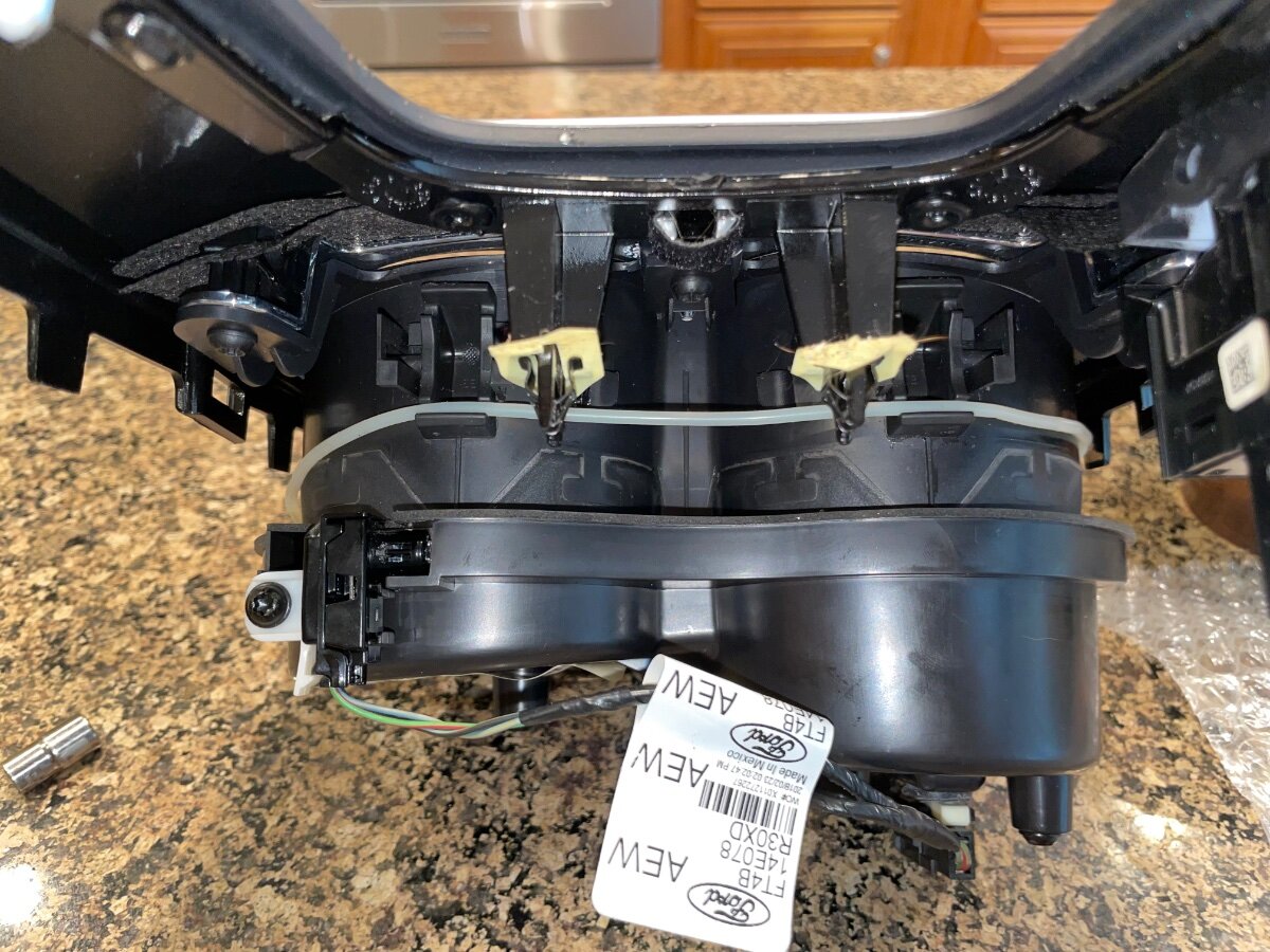

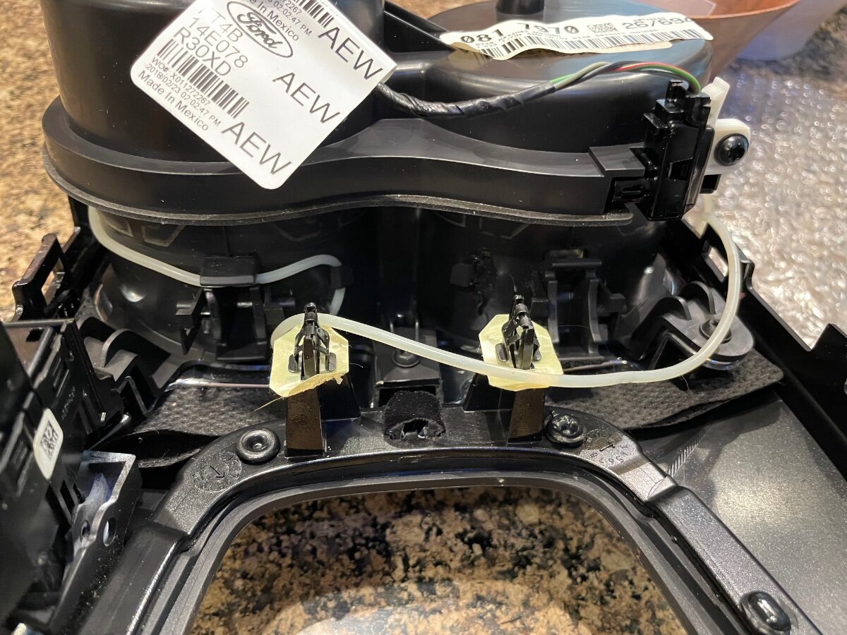

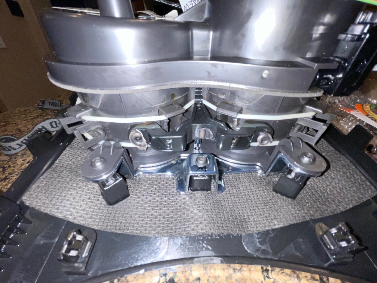

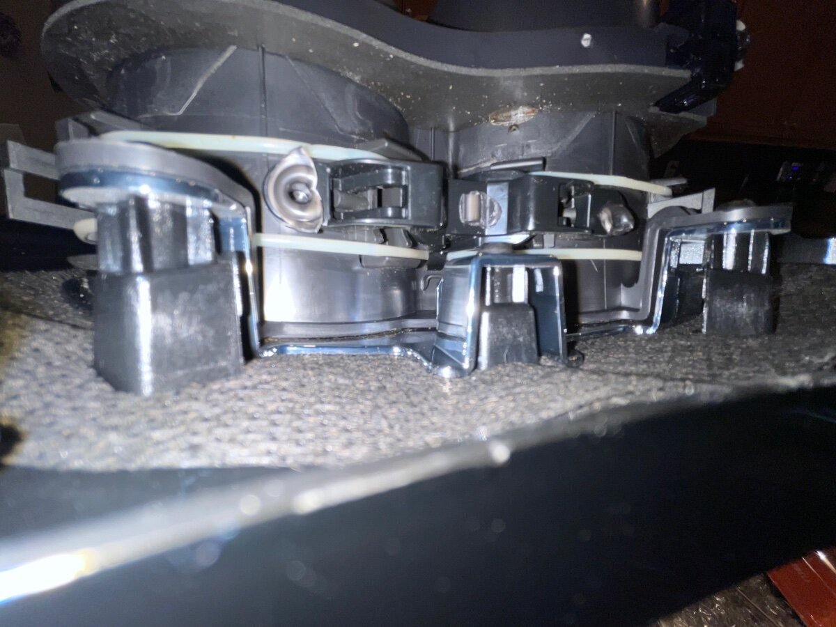

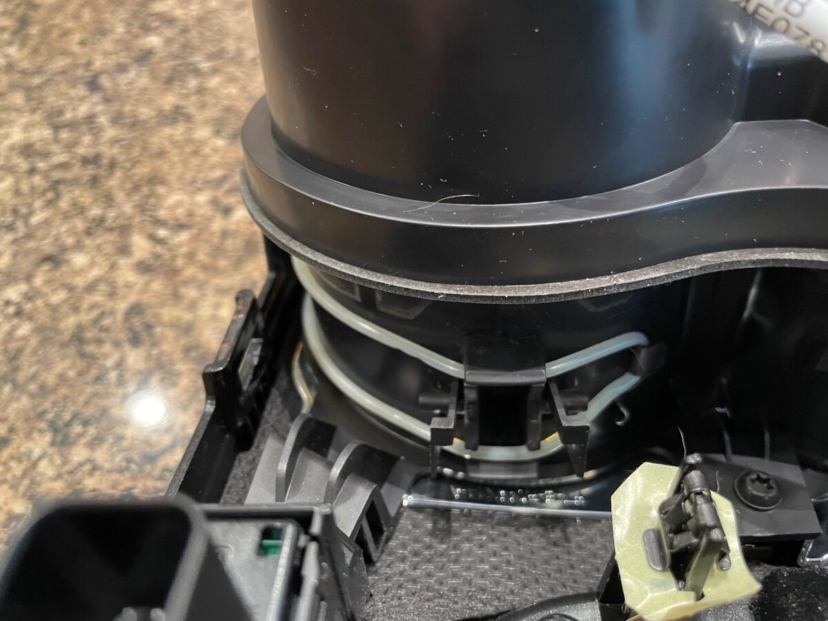

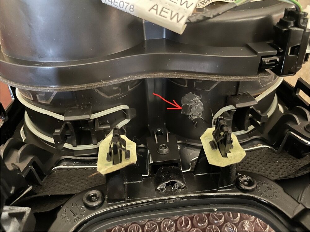

Cobra4fun Posted 19 hours ago Author Report Share Posted 19 hours ago (edited) I figured it out. See the photos below for the proper routing. I had one of the small broken tabs that needed to be JB welded back on. That’s why the “rubber band” came loose. Fixing it now. On the first photo below the cup holder on the Right-side in the photo is a mirror image of the loop on the left. I was repairing my tab so I didn’t show it. Edited 19 hours ago by Cobra4fun 1 Quote Link to comment Share on other sites More sharing options...

Cobra4fun Posted 6 hours ago Author Report Share Posted 6 hours ago Yep, this specific tab (red arrow) that the rubber band wraps around, broke free slightly to allow the rubber band to come off. Now I know why the cupholder retainers weren’t working and we’re rattling in the car. A little JB Weld should repair it so I can wrap the rubber band back around it. 1 Quote Link to comment Share on other sites More sharing options...
