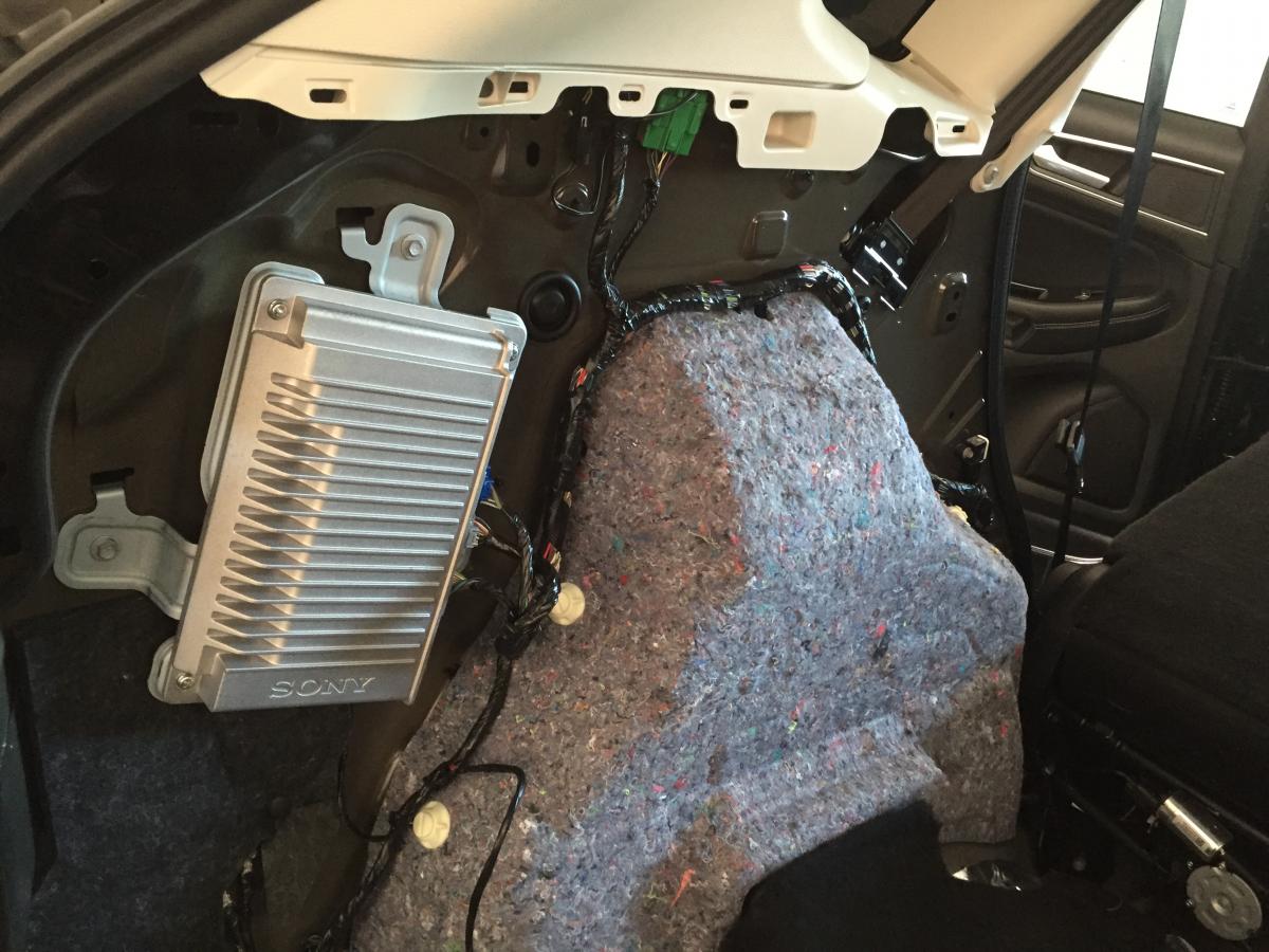

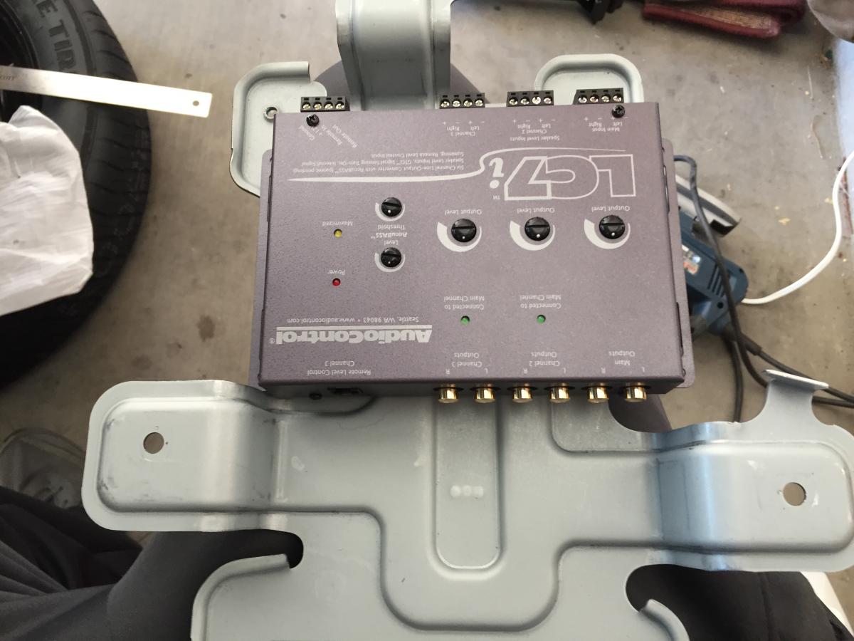

Yeah there isn't much room back there on a 2015 either. I was able to squeeze the LC7i behind the factory amp and crossovers will be mounted in there also. My Alpine amp will be going the same place as yours. Looks good! -

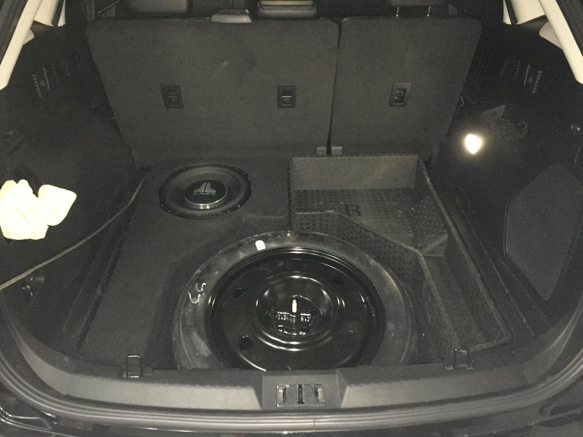

I have 2 12's downfiring in my f-150 about 1/2" off the floor. Subs don't care as long as they can move the air on the outside, nondirectional, and a grill through my floor would define the "hidden" idea. There is plenty of free air to move around under the seats and the floor, it also has about an inch of gap on the edges of the where I added the spacers. If I run into any issues I will be sure to update. Still trying to figure out if I should tap into the full range feed prior to the DSP or sum the signals after the DSP. I have read that on some systems the pre amp is flat levels without volume control.
I am sure it will vibrate but not rattle. Using rubber spacers helps. I plan on putting a rear mat down so that will help also. There is plenty of room to vent the output without causing pressure build up. More concerned about sound deadening the back hatch, and other rattley bits in there. I'll update if I finish it up and it sounds like ass.

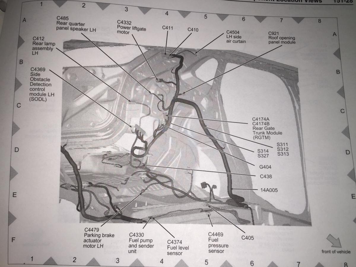

Uploaded the wrong page, but it is the box next to the SODL module in that pic -
Still waiting for info on interior panel removals. But if anyone needs it, here is the wiring for the 2015 Edge with Sony Premium wiring diagrams. http://imgur.com/a/Vz3rT

Currently waiting for more info on the 2015 interior trim removal before getting started on this. Just don't want to foul up any of my interior! But for anyone wanting to know, here is the wiring scheamatic for the 2015 Edge with Sony Premium sound. Happy to see I won't even be working behind the dash, seeing as the DPS is in the rear quarter panel driver side.

And so now for the questions and concerns I have. 1. I upgraded to the LC7i 6 channel because I was going to tap into the front and rear door outputs. But the more I look into the "Sony Premium" wiring it looks like the fronts have a separate line for the in door tweeter instead of tapping into the 6x8 using caps as cutoffs. I can only assume this means the 6x8 is getting Mid range Hz's and the tweeter is getting the highs, all the way from DSP. If that is the case, I don't want to tap into a limited frequency range for my pre amp wiring. Where is the DSP located? I have the actual 2015 edge wiring manual on the way, as I couldn't find a solid source for this year. I will be sure to share any info I come up with on this trip. 2. If I end up only taping into the rear doors (assuming they have a full range feed, suspect they have separate tweeters as well, hopefully piggybacked off mid), should I downgrade from the LC7i since I will lose any fading ability anyway? 3. How are you guys dealing with vibrations added by more power? I hooked up my box to my truck amp and was amazed at how much vibration I had coming from a $40K vehicle. The doors seem to be holding up to a lot right now so hopefully they wont be a problem, but that tail end all the way up to the mirror and dash vibrate like crazy. Going to have to get creative. I had even tried putting the sub on the deck, thinking I had made a horrible mistake by building the box onto the body, but "luckily" it was the same in a standard location. 4. Any suggestions on rear door speakers? Never seem to be a priority with me, as stock speakers sound pretty good amped up usually. 5. Tips and tricks? Hidden screws that will ruin my day when trying to take a panel off? How to stop your wife from killing you when she sees her interior ripped out? Number for a good attorney? Any thing good like that! It will be an adventure, I will try to take pics and document progress. All gear is on its way, should start this weekend.

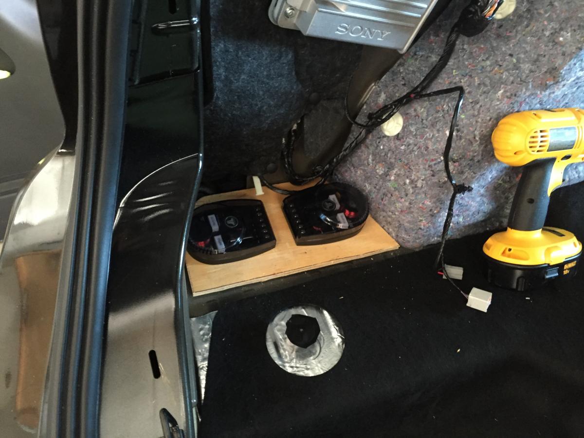

Hello, New here but love the new edge sport I "got for my wife". I finally heard her say "It just doesn't sound as good as your truck" and I knew it was a go. Even though I have the Sony Premium sound, it just doesn't cut it. I planned a build using the left wet storage container as a mold for a shallow mount 12 and here it is. I will be installing: Alpine PDX-V9 (4x100 + 500x1 @ 2ohm) JL TW3 12" shallow mount Custom "First attempt ever at fiberglass/what the hell am I doing" box JL C2-650 6.5" component set for front doors LC7i 6 channel Line Output Converter As much sound deadener as I can cram in there, sounded like a tin can when I hooked up an external amp. The plan And so it begins My first attempt at fiberglass and I can tell you, use one set of clothes that stays outside, use solo cups, and it sucks but is worth it. Test fit, added a "structural support curvature" to the long section. Will have to fix that. That will do Have since fixed my nasty seam, a little better. With the deck on "under the hood" Plenty of clearance.Will probably end up putting a grill on it, but deck is very rigid, will add support in the middle near the spare also. Spacers are rubber stoppers epoxied together with a screw through it into the plastic frame.
