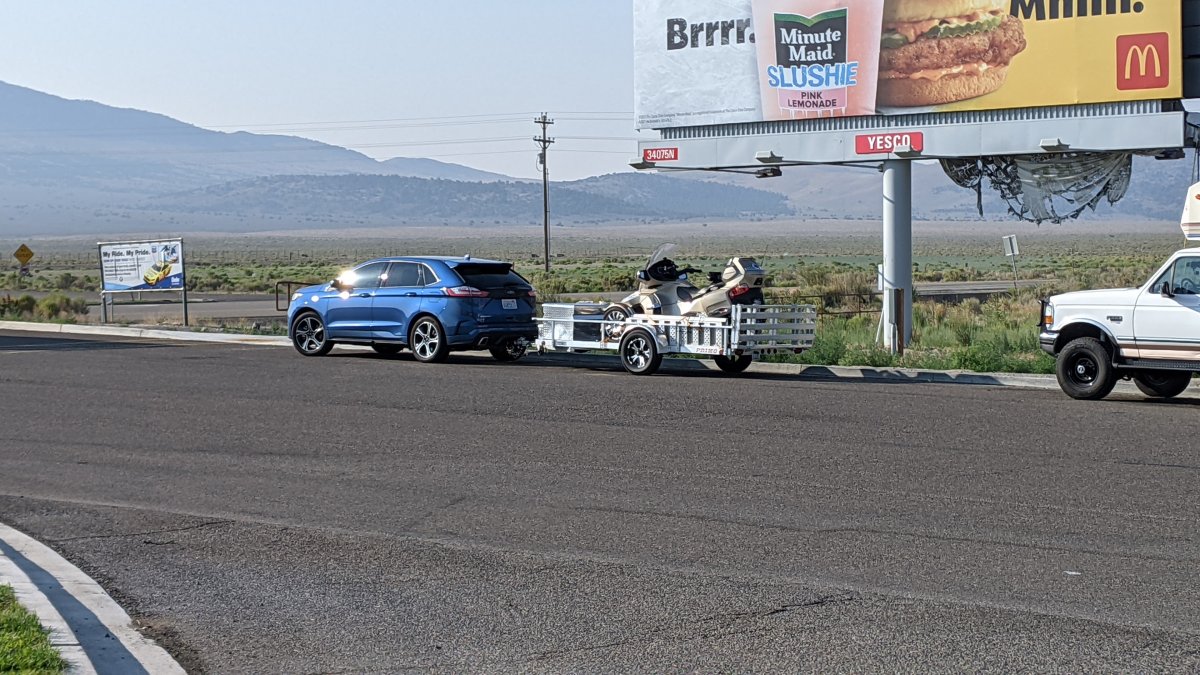

I averaged 17.5+ at 68 MPH on a 1450 mile trip for Arizona to Washington last month. I think this is more in line with Ford's intended towing for the Edge. -

So I tow my Can Am Spyder from Arizona to Washington on an open trailer 3 weeks ago and it did just fine. When I get back to Arizona I have a Kawasaki KRX 1000 waiting for me. It is going to be heavier and I think I will install electric brakes on the trailer. Could you give me a run down on the brake controller you are using and the wiring that you had to do? Thanks Chris
