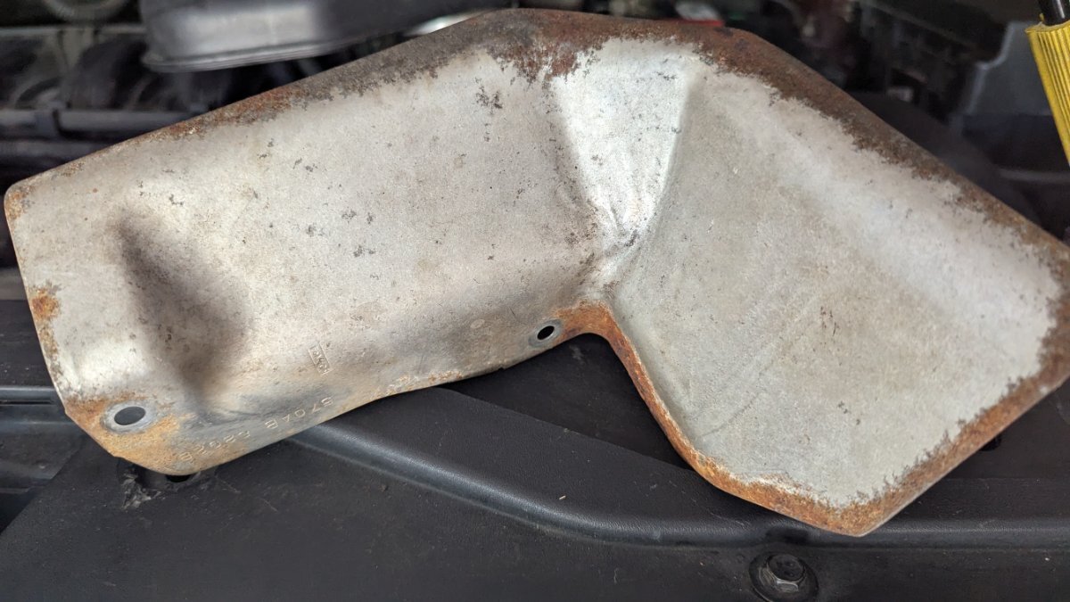

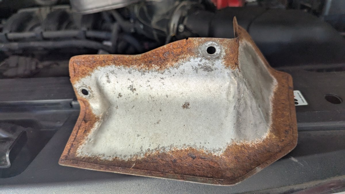

People should look on ebay (though I just got screwed by ebay on a return shipping scam). There are multiple sellers selling this same part for 1/2 the price with the heat shield and the drain plug. It worked well in mine. Probably would last 100k. The original lasted till 168. I did the entire firewall refill setup, would be easy to service. Bought a measuring injector (plastic). Measured what came out, then put that back in, did not have to mess with filling it under the car.
Dealing with my 2nd Edge PTU service. The last one had the slick drain and fill setup. This is the original ptu. I have done 2 suctions thus far. It certainly needs an exchange after looking at the lube. With this service I could only get 30% of the fluid out of it before the thin hose bottoms out in the case. It is probably a bit better than it was but I am debating the virtues of a drain plug. There was no metal present at all. I threw out my old ptu. Does anyone know the thickness of the case? Is there an idea location to tap if installing a plug? I am trying to find the lowest point possible. Thought I saw something about this a long time ago but I cannot locate it in the forum now.
