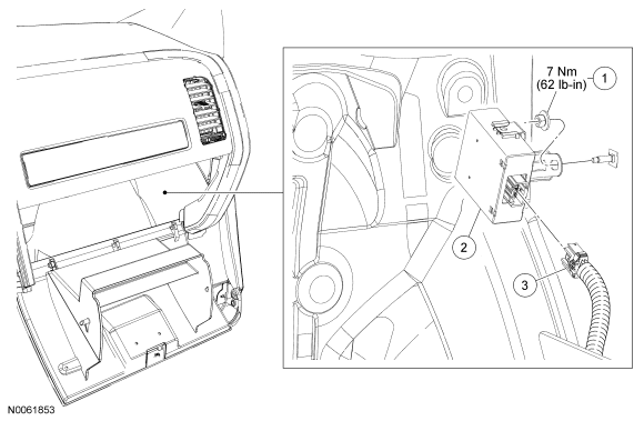

spitfire365 Report post Posted June 19, 2015 (edited) New to the forum. So sorry if this isn't the right place to post. But I have a code p1825 which I know is 4WD Clutch Relay Open Circuit. Bought a Haynes manual to see if that had a pinpoint test. That was joke. But anyway i was wondering if anybody has got a pinpoint test for a 09 ford edge which obviously is awd. Also if someone can tell me where the awd control module is that would be helpful and i have checked the fuses. 83000 miles owned about 3 months now. Edited June 19, 2015 by spitfire365 Share this post Link to post Share on other sites
WWWPerfA_ZN0W Report post Posted June 19, 2015 (edited) From the 2007 FSM: Item Part Number Description 1 N621906- S424 Four wheel drive (4WD) control module nut and washer 2 7H473 4WD control module and bracket nuts 3 — Electrical connector (part of 14A005) Removal and Installation Open the glove compartment, press in on the sides and lower it to gain access.From below the LH side instrument panel, remove the hush panel.Disconnect the four wheel drive (4WD) control module harness connector.Remove the 4WD control module nuts. To install, tighten to 7 Nm (62 lb-in). Remove the 4WD control module and bracket.To install, reverse the removal procedure. Edited June 19, 2015 by WWWPerfA_ZN0W 1 Share this post Link to post Share on other sites
spitfire365 Report post Posted June 20, 2015 Alright thank you for the location. I got the 09 fsm on the way. I appears someone has had this problem before three of the wires on the harness to the module had been split and left bare. Share this post Link to post Share on other sites
