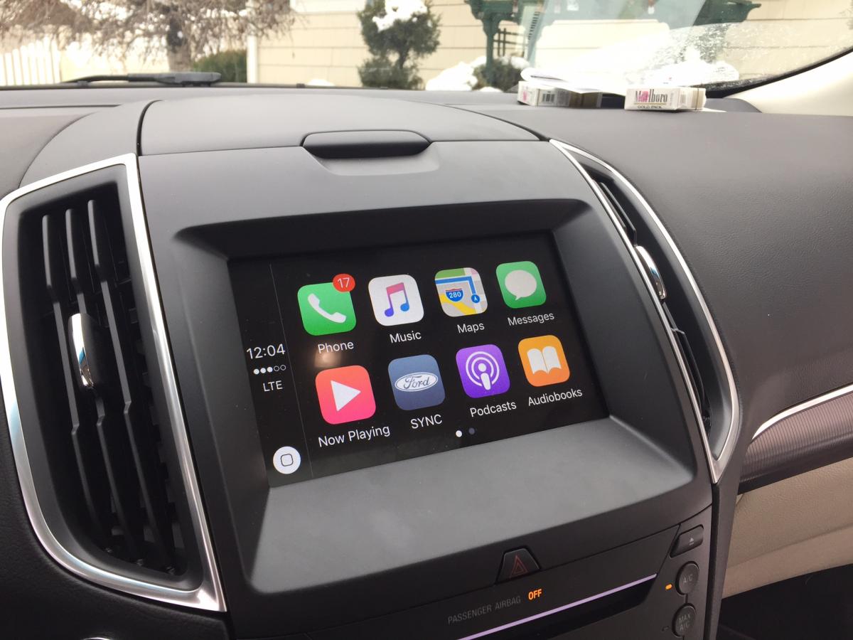

2016_Titanium Posted February 7, 2017 Report Share Posted February 7, 2017 So....picked up my new 2016 Edge yesterday and notice no Apple Car Play. Currently have Sync version 2.0 which is Car Play compatible but according to what I am seeing I need to upgrade the USB hub in the console area. Ordered part # HC3Z-19A387-B from Sweeney Ford and picked up a trim removal set from Amazon for $6. Hope to tackle the replacement this weekend, will let you know my results. Quote Link to comment Share on other sites More sharing options...

2016_Titanium Posted February 11, 2017 Author Report Share Posted February 11, 2017 Success!!! One attempt to remove from the front and said.....no way this will be easy. Removed trim from passenger side center console, really easy by just pulling and popping the clips out. Then removed the rear cover to the center console behind the USB port for full access. Felt for the tabs and squeezed my fingers in there and pressed the tabs down while pushing on the back and it slid right out. Tied off the wires with a couple pieces of fishing line so they didn't drop back in. Each connector for the hub had a small clip, removed the old and connected the new. Plugged in my phone and Apple Car Play came right up, accepted and looks beautiful. All in all really easy to swap out, maybe 20 minutes tops. Quote Link to comment Share on other sites More sharing options...

mga Posted February 15, 2017 Report Share Posted February 15, 2017 (edited) one more question: if you're using maps on CarPlay, and you switch over to the car's radio, for example, will the maps still be running in the background with voice directions as well? or, does switching back to the sync2's main menu cancel CarPlay? I'll find out soon enough but I was just wondering about that. update: installed in about 20 minutes and worked!! I was nervous removing the plastic in the cold but nothing broke or cracked. (whew) wife is happy. thanks to you guys in this forum!!! Edited February 15, 2017 by mga Quote Link to comment Share on other sites More sharing options...
